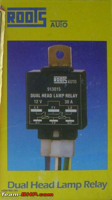

Originally Posted by nishantgandhi View Post
Here are the pics of the Bosch mini relays and back of the ceramic holders. Could not click pics of the actual install as I had left the car with my mechanic.
Thanks for posting the pictures, Nishant.
Aah, the mini relay is just like the 4 point relay that comes with the Stebel Nautilus horn. IMO, the ROOTS relay is much better in terms of durability. Not to forget, the wires DO NOT need to be cut to mate with the relay (as done above), when using a ROOTS wiring harness.
Attaching a picture for everyon's reference.
Auto Lighting thread : Post all queries about automobile lighting here-roots-relay.jpg
