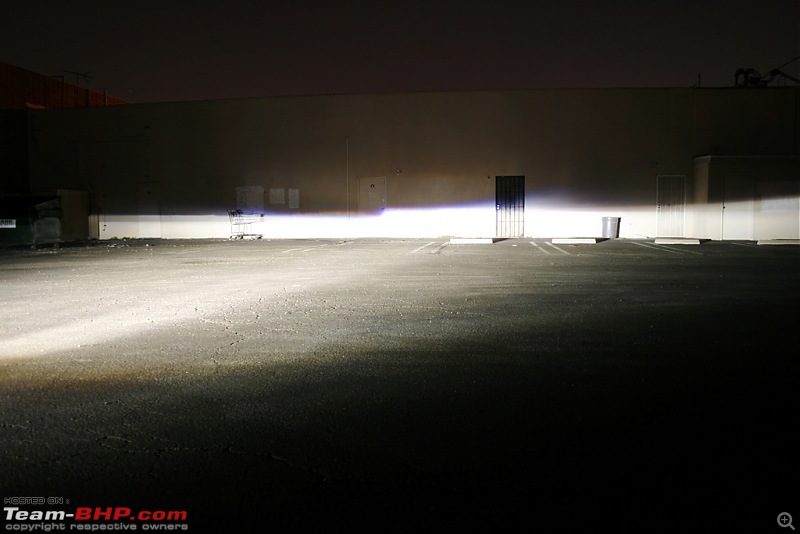

I did some research and found out that one of the bulbs is deliberately lower to avoid glare on the oncoming traffic (Source : forum on Acura's site)
I am totally confused now.....I am thinking to continue like this anyway as the high beam light is partly out of alignment and as moral responsibility, I plan to use the low beam 90% of the time
This is true only in the case of projectors. They have a plate inside which is cut in such a way that the right side is dipped down to avoid glare. Of course, in LHD projectors, the plate is cut in the inverse way.
The bulbs have no such systems. In case you're curious, in bi-xenon projectors, it is this plate that is actuated by the solenoid and folded down when you hit high beam (thereby letting the projector... umm... project the whole beam onto the road).
EDIT : Added a couple pics to show you what I mean.
