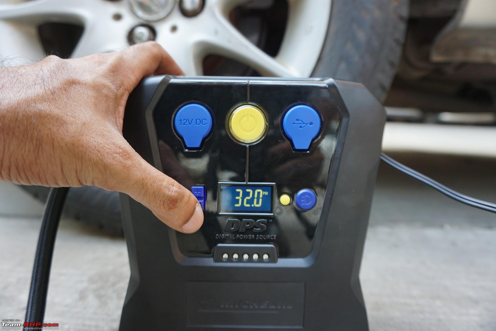

The piano black panel at the front houses a 12V power outlet on the left, a 5V USB port on the right and a large yellow ON/OFF switch in the middle. An air pressure digital display is placed below. The inflator is equipped with a pre-set feature which helps you to set the required pressure beforehand. A switch to increase or decrease the desired pressure is on the left and a reset button is on the right. The reset button can also be used to toggle between the unit of measure (PSI / BAR / kPa). Five tiny but bright LED lamps are located below the display screen. The switch to operate these is located to the right of the reset button.

Piano black panel with 12V and USB power outlets, switches, digital display and LEDs:

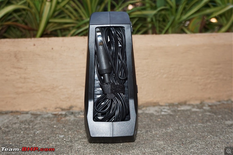

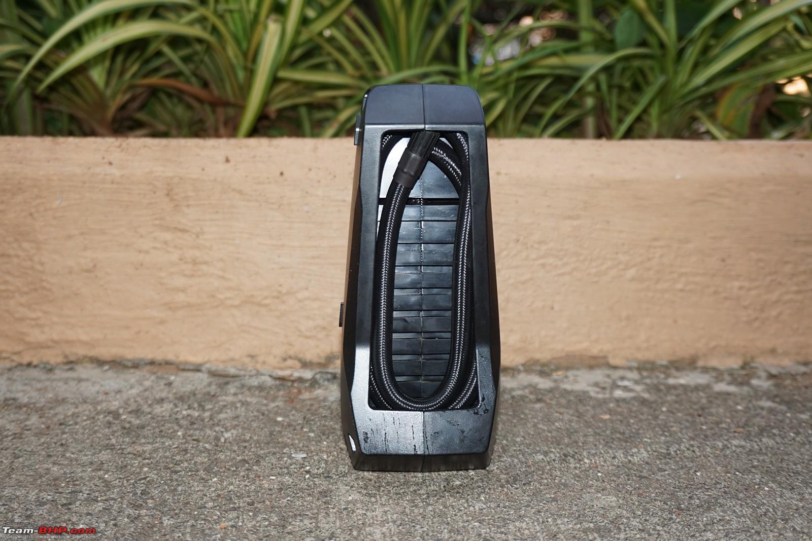

Power cord is neatly folded and tucked away in a groove on the right...
...while the air hose sits on the left:

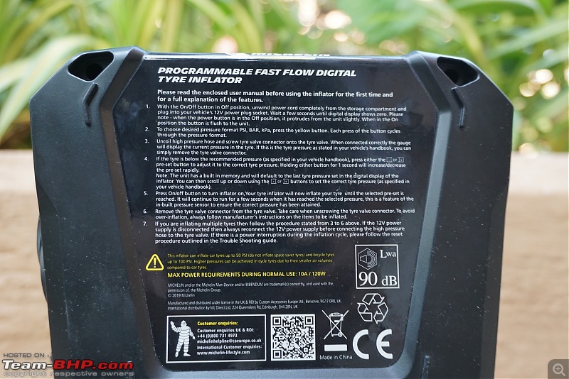

Instructions for use are pasted on the rear:

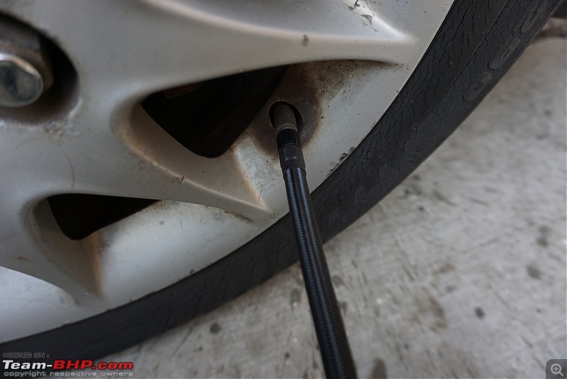

Air hose needs to be screwed onto the valve just as you would a valve cap. This can be tricky if there are salt deposits on your tyre valve:

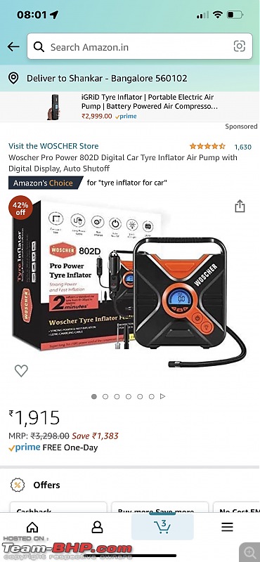

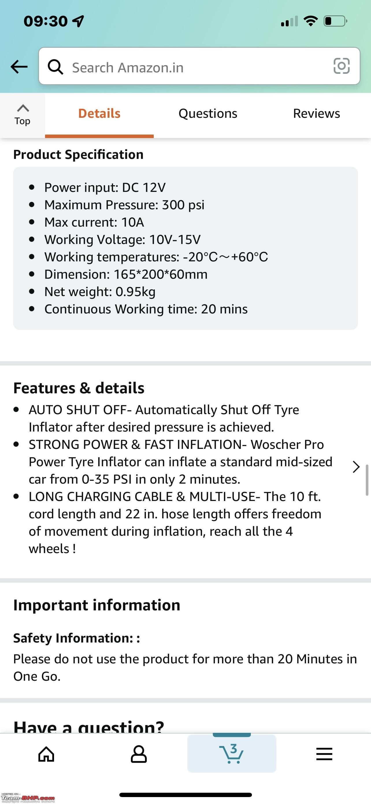

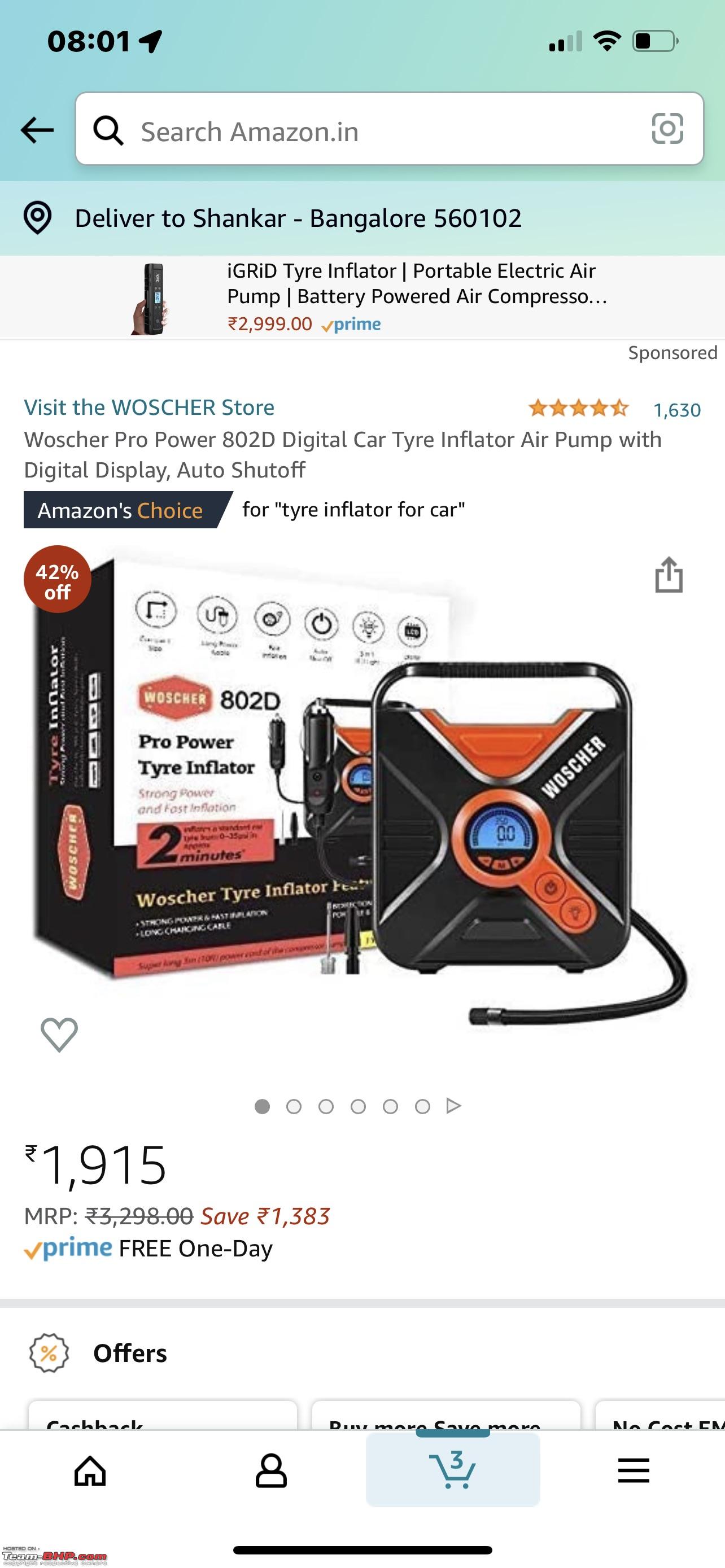

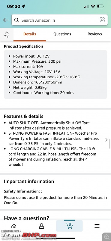

I use this brand Woscher bought on Amazon. It says that it is a heavy duty inflator.
It works well as per my experience- takes about 18 minutes to inflate my Thar’s tyre from 0 PSI to 34 PSI. And about 15 minutes to inflate my Cooper’s tyre from 0 PSI to 32 PSI. This was my experience when I encountered an absolute flat tyre situation, luckily it happened overnight and at home itself so less stress overall.
If called upon to use it, I make sure the car engine is running so as not to juice out the battery. I didnt hear any straining sounds at all. It gets power through the cigarette lighter or charger outlet. It has a pretty long wire. And it is easily packable and portable.
