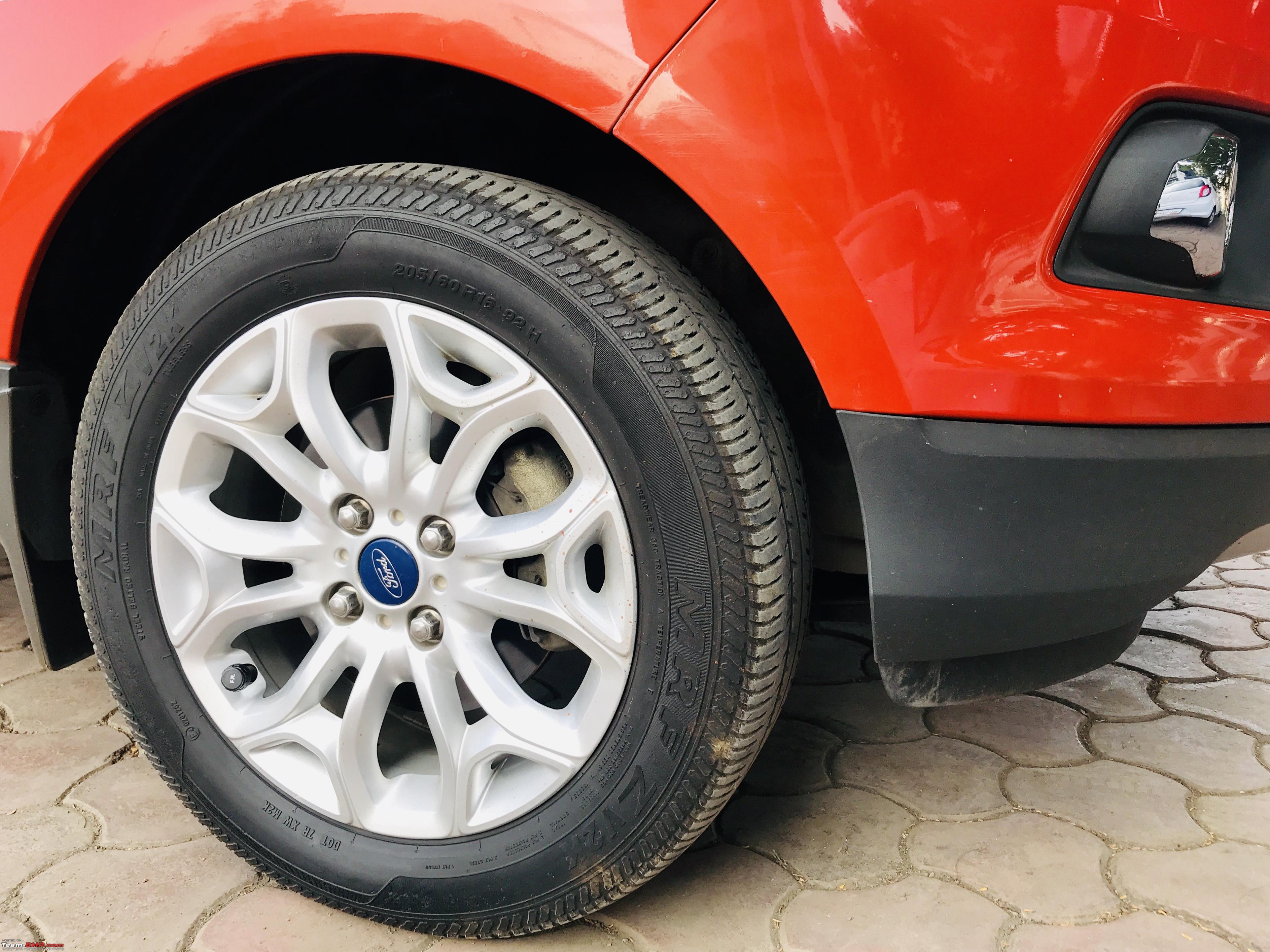

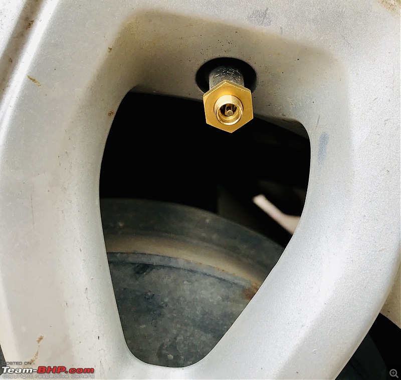

Installation

+It took 5-10 mins to install the external sensors. The sensors have some weight. No idea if wheel balancing is necessary.
