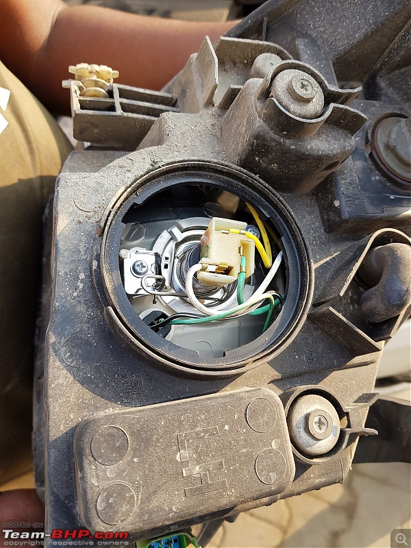

The plug on H4 lights are basically a male version present on the bulb directly compatible with the ones inside the headlight assembly. Makes it a drop in replacement to swap the lights
In the pic below you can see the sizes perfect and a drop in replacement for the existing bulb. Ofcourse the cooling fan at the back can cause variation which needs to be understood before choosing a specific model

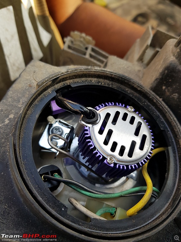

First time around i chose to goto my neighourhood garage for getting the lights replaced. I intentionally got the headlights removed to do the swap so that close examination can be done to ensure no issues can arise. Once this was done I have been able to do this again multiple times on my own as part of my experimentation. Closer look at the swap
In the above pics you can see despite the fan on the back the light fits well and the dust cap was easily tightened without an interference. The power supply for the light goes within the casing of the headlight and doesnt cause much complexity in the fitment. A point to note that all these LED lights come with a H4/7 etc shaped ring which needs to be fixed in place of the bulb and locked down with the metal clip. The light in itself is inserted afterwards otherwise the back fan and heat sink wont allow the clip to close.

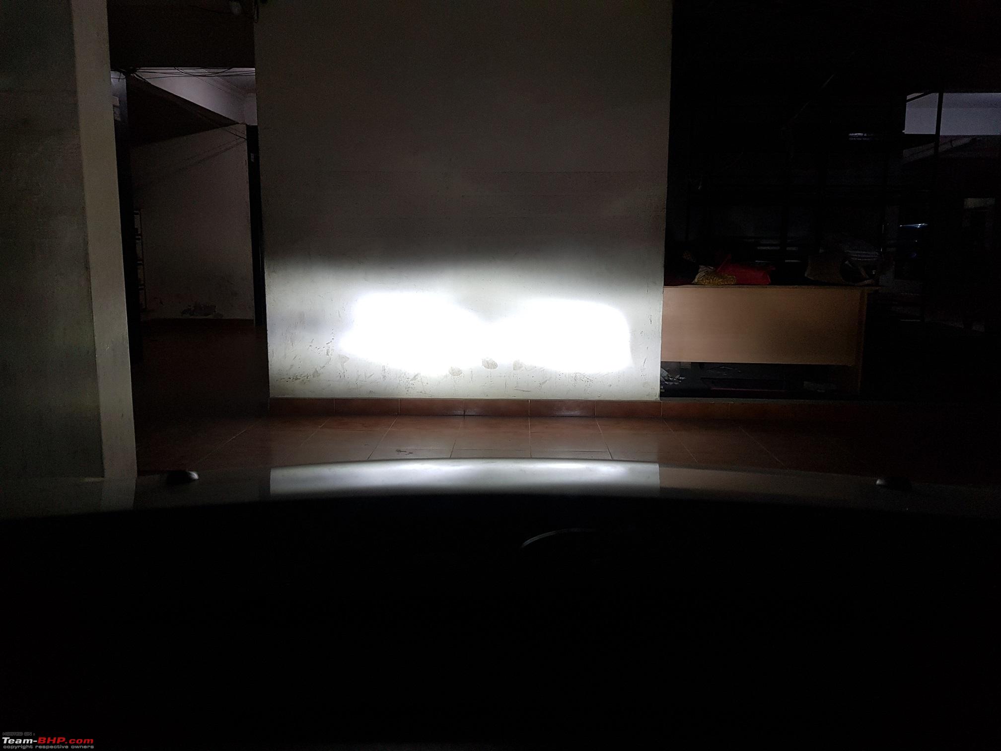

Pic of the low beam patter post install. You will notice that its missing the standard pattern of upward slant to the left. More on this later. But the cut is clean and there is minimal light spilling upwards which ensure onward traffic is not blinded despite the non standard beam pattern.

You may have noticed the beam from the right light seems lower than left, this is inherent effect of the beam pattern the light has. To fix this I raised the right light a bit more than left to make it balanced on the road. Overall the result is significant improvement compared to the Osram night breakers I had. Biggest improvement is on high beam when both hi and lo LEDs are on and they illuminate the road very nicely. To quantify the overall brightness I did some Lux measurements on my phone using an app that reports light sensor reading. Parked the car at same spot before and after the change and measured the brightest spot at low and high beam.
  • Osram -> Low Beam - 2500 lux, High beam - 2800 lux
  • LED upgrade -> Low Beam - 3500 lux, High Beam - 5000 lux
As expected high beam is way more brighter due to all LEDs being on, low beam is also better though not as significant as most brands advertise.

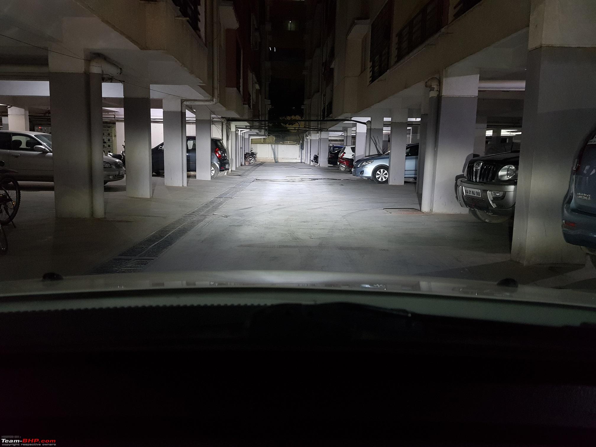

XUV low beam pattern post install. As perfect as it gets. Can you tell something is wrong? More on it later.
If you pay attn to the beam pattern you will notice the spread is too uniform. though it looks good on wall but has a practical problem on road. Typically the top cut off goes furthest and should be the brightest but in this case its almost other way around and the throw looks brighter near the car and gets reduced further from it. More internet research revealed its basically an issue of blob type LEDs and not having similar throw pattern as a filament of the halogen. Result was finding the latest gen of LEDs coming with CSP type LEDs which give a much closer throw like a filament and are more suitable for lights originally designed for halogens. I ordered another round from amazon after some research and reviews. Details below

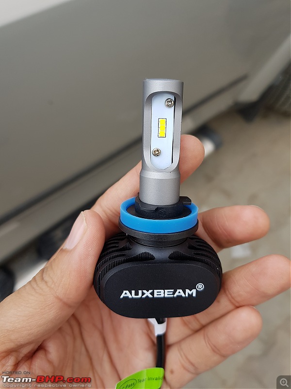

Pic below has the mictuning LED on left and the newer CSP on the right, notice how the CSP leds have a better light pattern with more brightness at the top

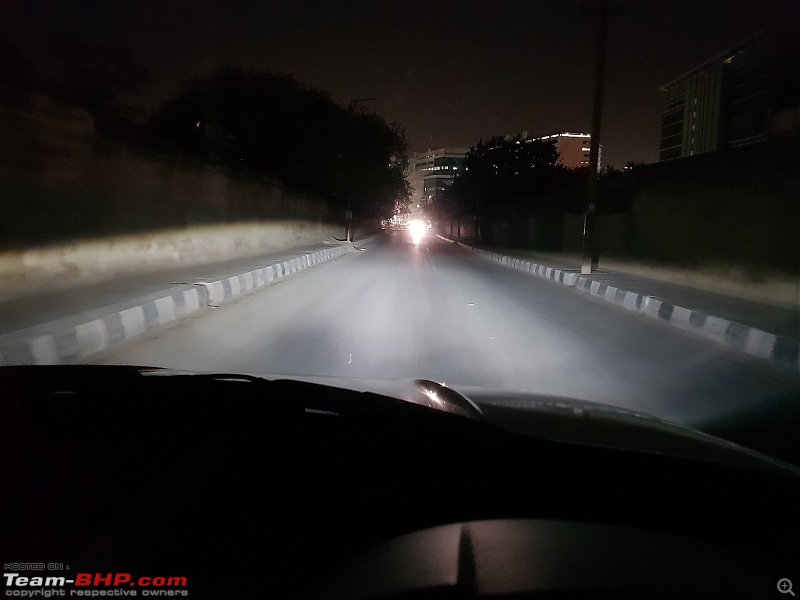

result on the road is also more impressive
I prefer driving with both low beam and fogs on to get uniform throw on the roads. After the LED conversion the halogen fogs start to look ugly but the H8/H11 fog bulbs have a different challenge for conversion. they dont have a housing and the lights are exposed. For this i chose another design from amazon which has only a big heat sink with power supply integrated. This results in a smaller design that should work better when exposed to our dusty environment. A fan based design will not last in our indian conditions without a proper dust cap. Chose Auxbeam brand which is surprisingly very good quality

  • Heat sink in place of fan, power supply integrated - This is exactly like the auxbeam model i got for the XUV fogs. Works best for H8/11 designs where light body is exposed and there is enough air flow to enable convection cooling from the heat sink fins. But still i have concerns with longevity due to higher temps
https://www.amazon.com/gp/product/B0...?ie=UTF8&psc=1
Excellent thread Supertinu. Your findings matches exactly what I encountered when trying out multiple LED options.
https://www.team-bhp.com/forum/diy-d...s-upgrade.html (DIY: Ford EcoSport LED Headlights upgrade)
The CREE array 2x2 LEd with the dome just don't provide proper beam pattern as the light source is different. The 1x3 CSP LED's come the closest.
I narrowed down to the same conclusion and went for xenon depot lights which were way more than the Auxbeam.
If anyone is coming down from US, I would recommend the Auxbeam or the Beamtech (both identical) LED. The reviews are really good and since they don't have a fan they will be more reliable.
The ones with fan are known to fail in our dusty environment, especially if the fan is exposed.
For the Figo H4 is a challenge in fitting since the entire LED assembly needs to fit within the headlight enclosure.
The H11, H1 and H7 are so much simpler and really plug and play types.
Hey Vid, yes look like we pretty much went through similar experience in parallel. You are right BeamTech and Auxbeam have the same sourcing mostly.
Figo headlights actually have lot of space between the body and reflector, so fitting it all inside was relatively easy.
Also periodically you can use compressed air to clean the fans, that should give them longer life since they are exposed.

The first product shown in my earlier post is what I have in both my hi and low beams. I didnt face any shadow or focusing problems with those.
The second one with the groove, which you are referring to, I have ordered it recently and yet to receive it. Pajero Sports has a reflector setup for hi beam, so I guess I will most probably face the problem you have mentioned. Will share results once I try out this product.
Yes, fan is open to engine bay and is exposed to dust. I can see there is some dust accumulated but its been going good so far. Hopefully it stays that way.
Maybe what you can do is use the black ones for low beam only. Inside the projector if the groove is facing down it wont cause shadow, but in high beam with reflector it will create a dark spot.
