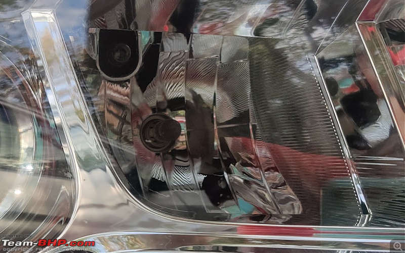

Anand, do you have separate low and high beams? maybe share a pic of the headlight to be sure.
Reflector as the name suggest is going to be look like bunch of mirrors vs. projector has a lens in front. Since your main interest is highway driving, throw distance of the light is important and nothing beats halogens for throw unless you get warmer 4300K LEDs which are in short supply.
Sorry for the late response. Yes, there are separate low and high beams. Pic attached.
And it is a reflector and not a projector.
Hence, do you suggest 4300K LEDs for the high beam? Any specific brand/model that you recommend? (Just to refresh - the high beam is a H7 and the low one is a H11) Thanks in advance.

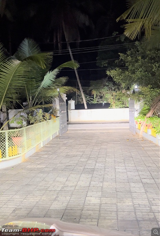

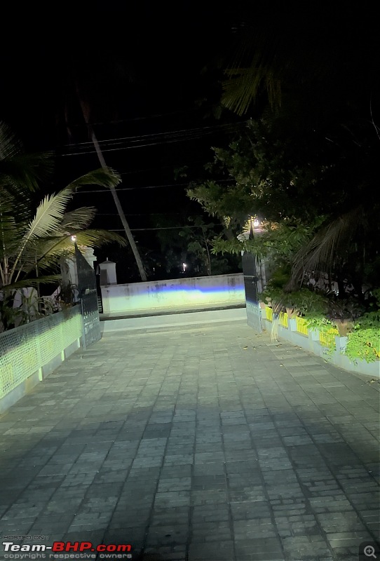

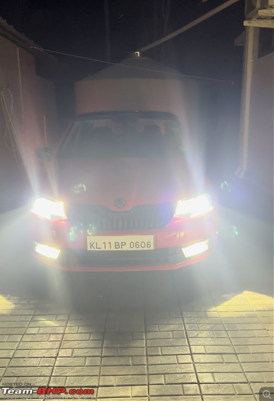

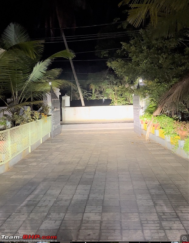

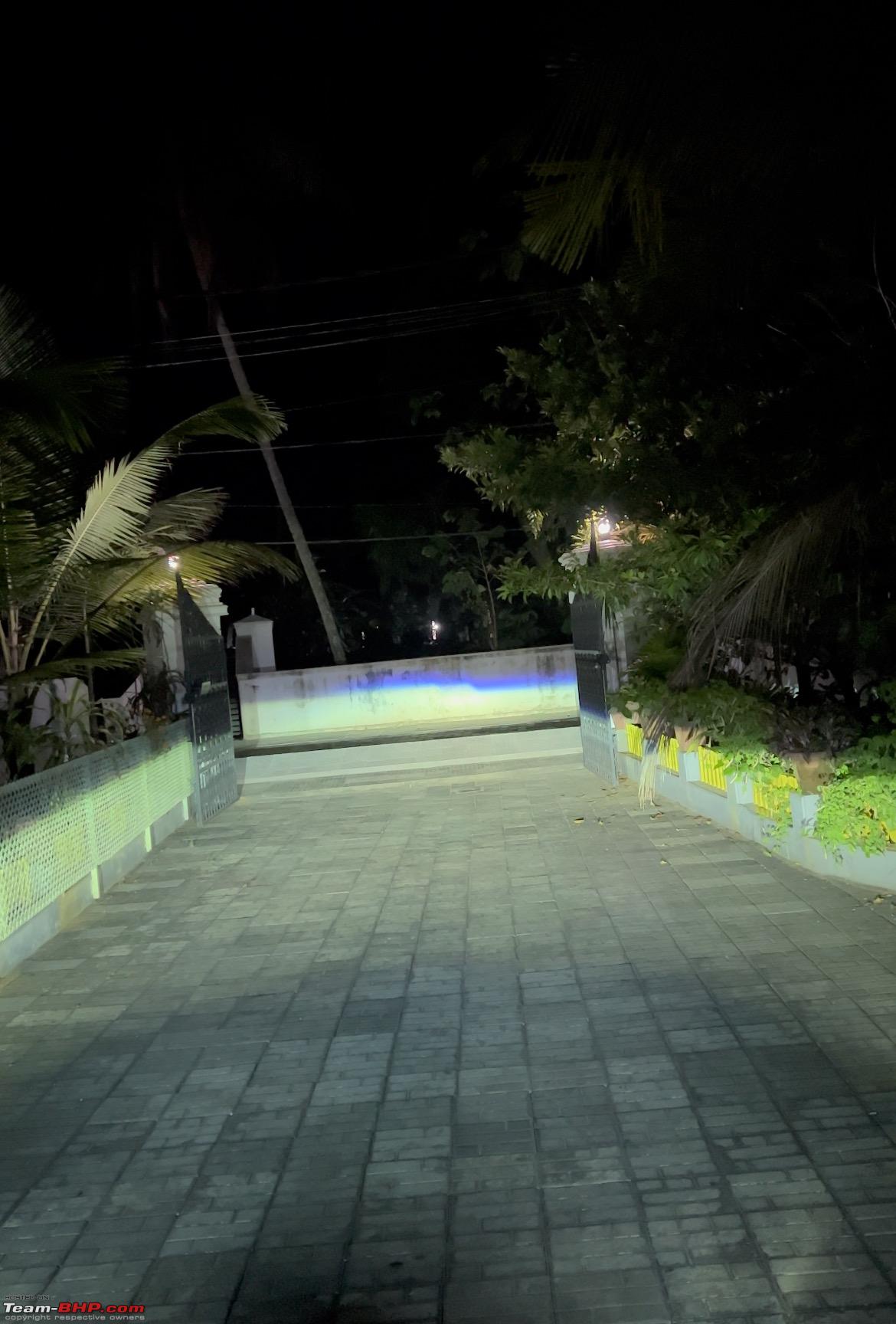

Finally last week i sorted out a long term known defect in Skoda rapid - The headlamp restoration and upgrade from Reflectionz car care Kochi
This was an issue that i was facing from the day i bought my skoda rapid in 2019. Initially i changed to LED’s for both projectors and high beams from Vagtune kochi but due to poor work and malalignment, it didn’t last long. In 2020 i changed to Azoom HID’s in projectors and stock halogen bulbs in high beams. This lasted for almost 2.5 years. In this duration due to multiple works, the rear cap was open due to which headlamp started fading eventually it started filling with dust and fungus. Then the search for a good headlamp restoration started. There are many people who does this along with detailing but all of them does it with a polish without opening the headlamp assembly.
But i found out Mr.Annson mathew who deals only with headlight restoration works. He is exceptionally talented in his work and this is reflected in his google reviews. I saw few of his works in his youtube channel, instagram and finally decided to make a deal with him . I contacted him, raised my concern and he was truly professional in his work. He explained everything in detail and we fixed a day i dropped my car in his garage. He did the following work
1. LOW BEAM - HELLA G5 BI XENON PROJECTORS
2. HIGH BEAM - OSRAM LED 50 W 4200 K
3. FOG LAMPS - DHC LED 55 W 4200 K
4. HEADLIGHT RESTORATION
Post upgrade, the throw was absolutely stunning. I never knew that i will get this much output. 4300 K is good even during rain. Now i’m truly enjoying night drives with these strong projectors.
post upgrade pic
Projectors ( Low beam)
Projectors + High beam

Front view with all six 6 bulbs in action
For this setup I would recommend that you stick with halogens for high beam ideally. Or you need to do some trials of LEDs on the reflector to see the quality of beam. You can order returnable lights from Amazon and fix on 1 side and keep the 2nd side halogen. Turn on against a wall and check if the LED beam pattern is as focused as halogen. If its wider than halogen, then its going to be really bad on highway for night driving since its scattering more. You can try this at an accessory shop as well if he is willing to do it. If you are trying on your own then go ahead with Osram LEDs, they are the best bet. Similarly OSRAM 6000K for low beam projector should work fine.
