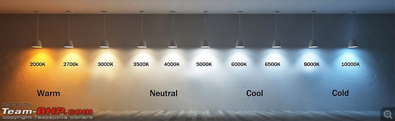

I reached out to their support email and got confirmation that these 4200K/6000K are two variants of the 50w led.
They shared this reference image. Comprehensive guide to LED Headlight upgrades-light-colors.jpg
Originally Posted by paraphrasing the email
OSRAM H4 LED Headlight Bulb, 50W, 4200K/6000K
ref: https://www.planetcarcare.com/collec...00k-6000k-pair
both variants are available
6000K is pure white light
and 4200K comes in Neutral color light
and difference is 50W LED is basically total 100W (50W each bulbs) while in 25W total Wattage is 50W (25W each bulbs)
I am glad to have a 4200K option. The other options in the market are too cool In my humble opinion.
