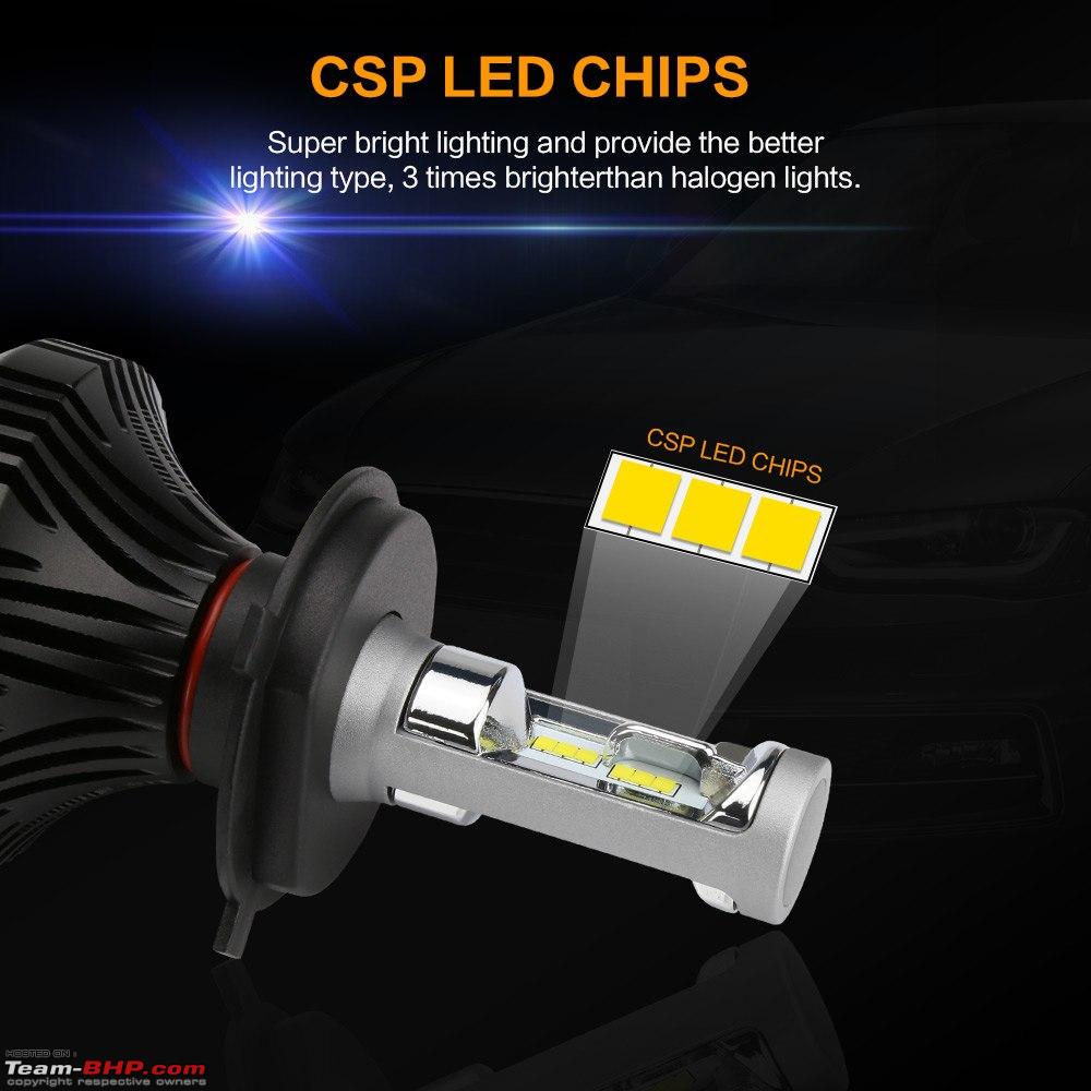

For H4 replacement LEDs, there seem to be two types. One is the multi sided type, that keeps it simple with either 2, 3 or 4 sides in a unit. One side acts as a low beam by illuminating only the top part of the reflector, while the other side illuminates the top part of the reflector to create the high beam.
For H4, the high beam suffers in most LED bulbs, as the placement of the light source has to match the original to get a good beam, as the high beam is produced by the rearmost part of the reflector, and relies on correct placement to create an accurate beam. The multi sided bulbs just throw more light all over the reflector and hopes enough of it will hit the spot to create a good beam. The result, IMO, is like having a flood light on. There is a lot of light near you, but the falloff is poor and you need a really bright bulb to get a good high beam.
This is where the new 4 sided LED bulbscome in. They claim it's an improvement over the older 3 sided versions. They come with a separate LED driver unit, which means the heating shouldn't affect the LED drivers. They are said to be 100W per set, (50W per bulb). For H4, it should be 25W in low beam and 50W in high beam, which is quite high for LED. Typically, LEDs are 50W per set, or 72W per set.
If someone has installed these new types of bulbs in their cars, please provide some info regarding their performance. I have ordered a pair, but the order got delayed and then got canceled as the package got damaged and they were out of stock.
Here's a link on AliExpress where you can buy them, or get more info
Here's a different seller, OSLAMP
These ones from HLXG are CANBUS compliant
