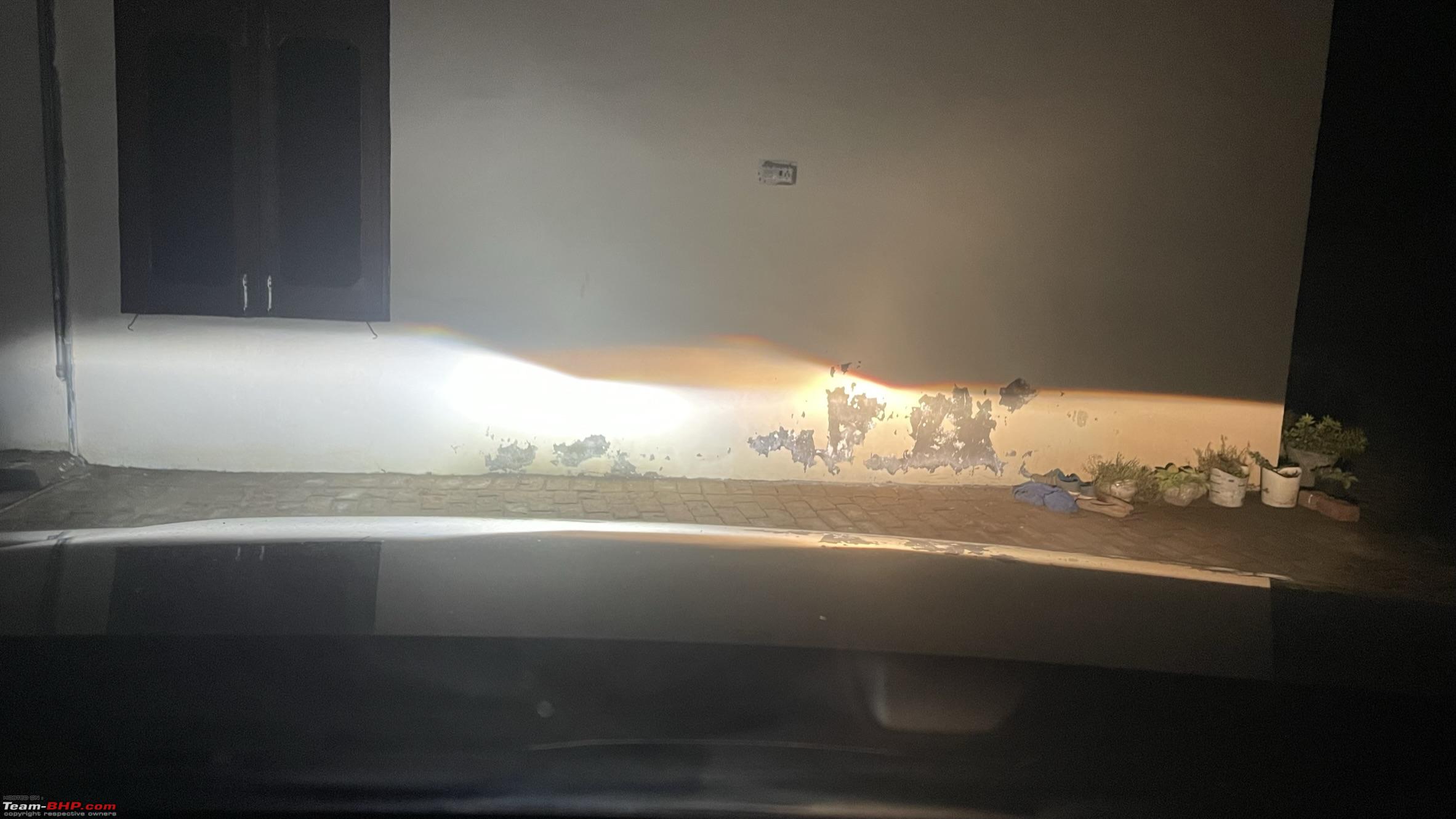

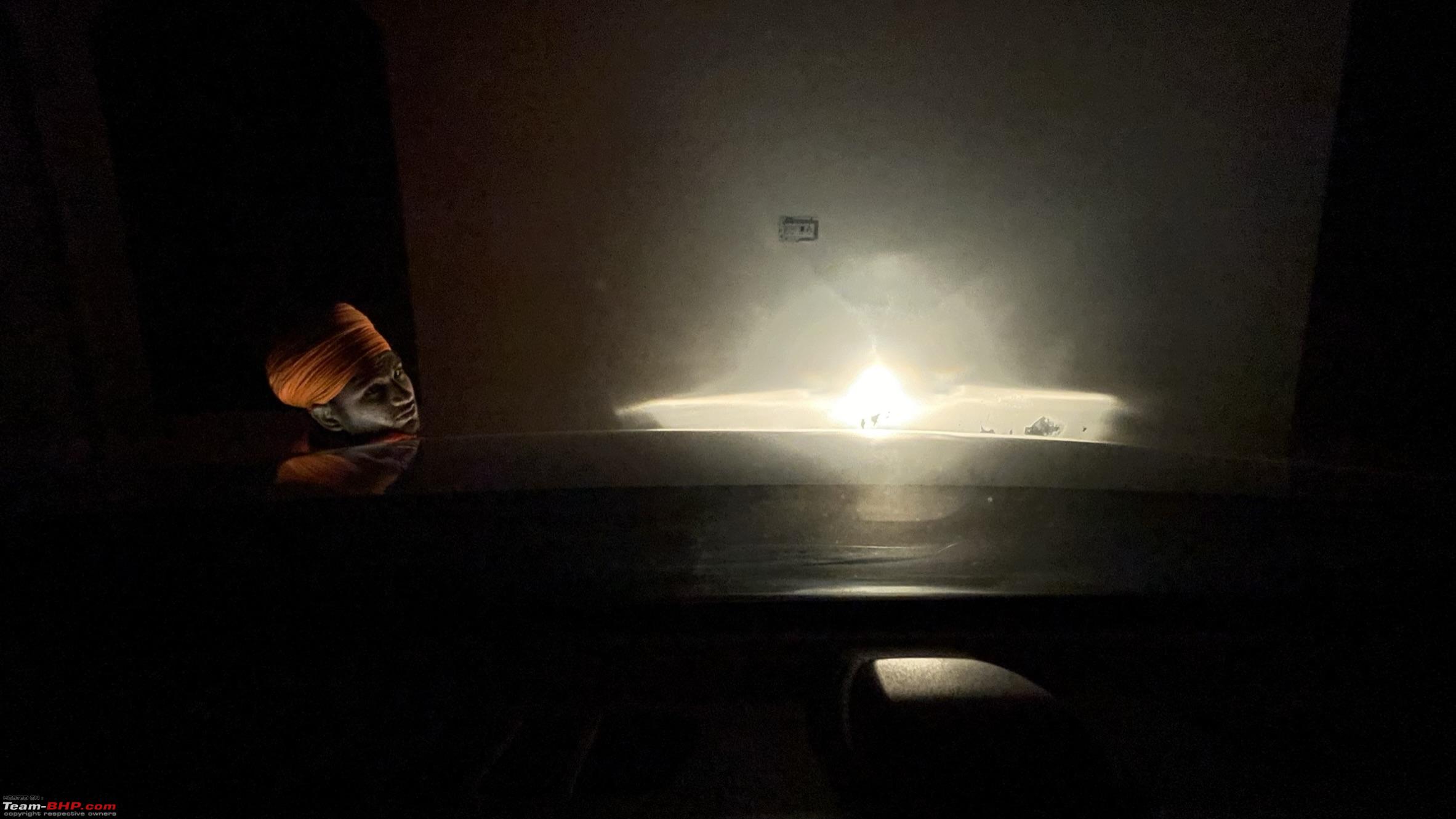

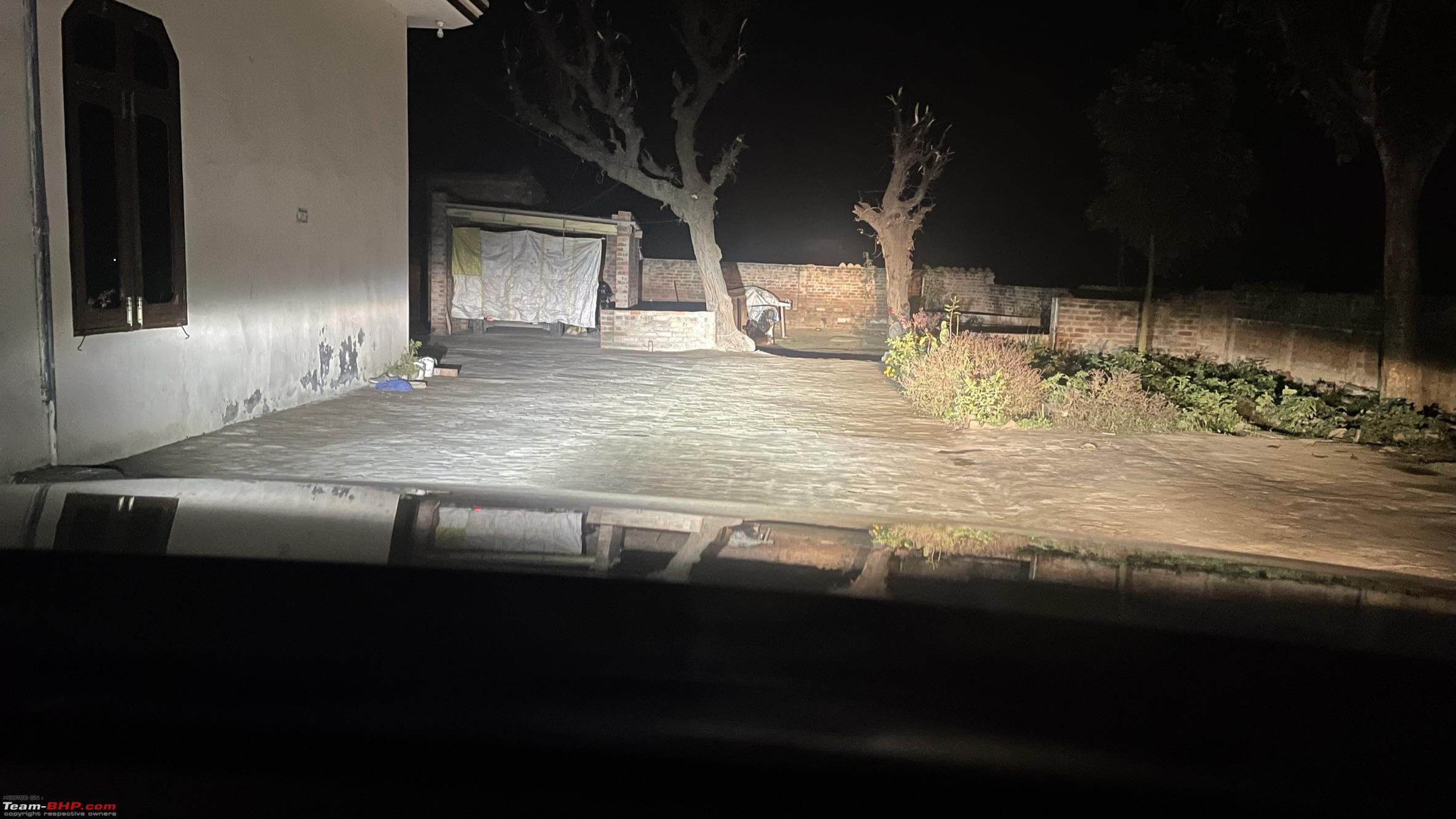

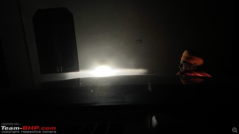

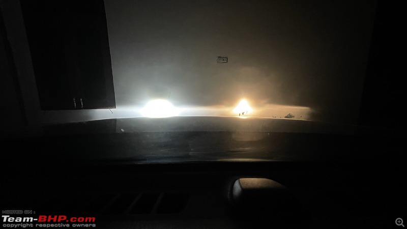

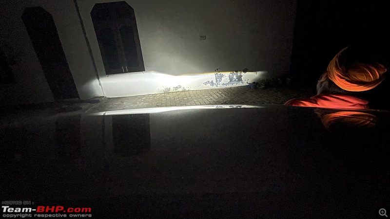

I’m attaching below the comparison pictures of LED vs halogen in projectors.
Car: Hyundai Creta S 2020
Stock Headlight specs: HB3 Halogens in halogen projectors 60/55w
LED Specs: GVAA HB3 6000K LED 45w(claimed, not tested)
Setup: Aftermarket LED in passenger side headlight, stock halogen in driver side headlight
Additional notes: Same HB3 projectors used in Verna, i20, Venue, Seltos, hence results applied to all these vehicles as well.
Please find below detailed shots of performance during a cold winter evening.
