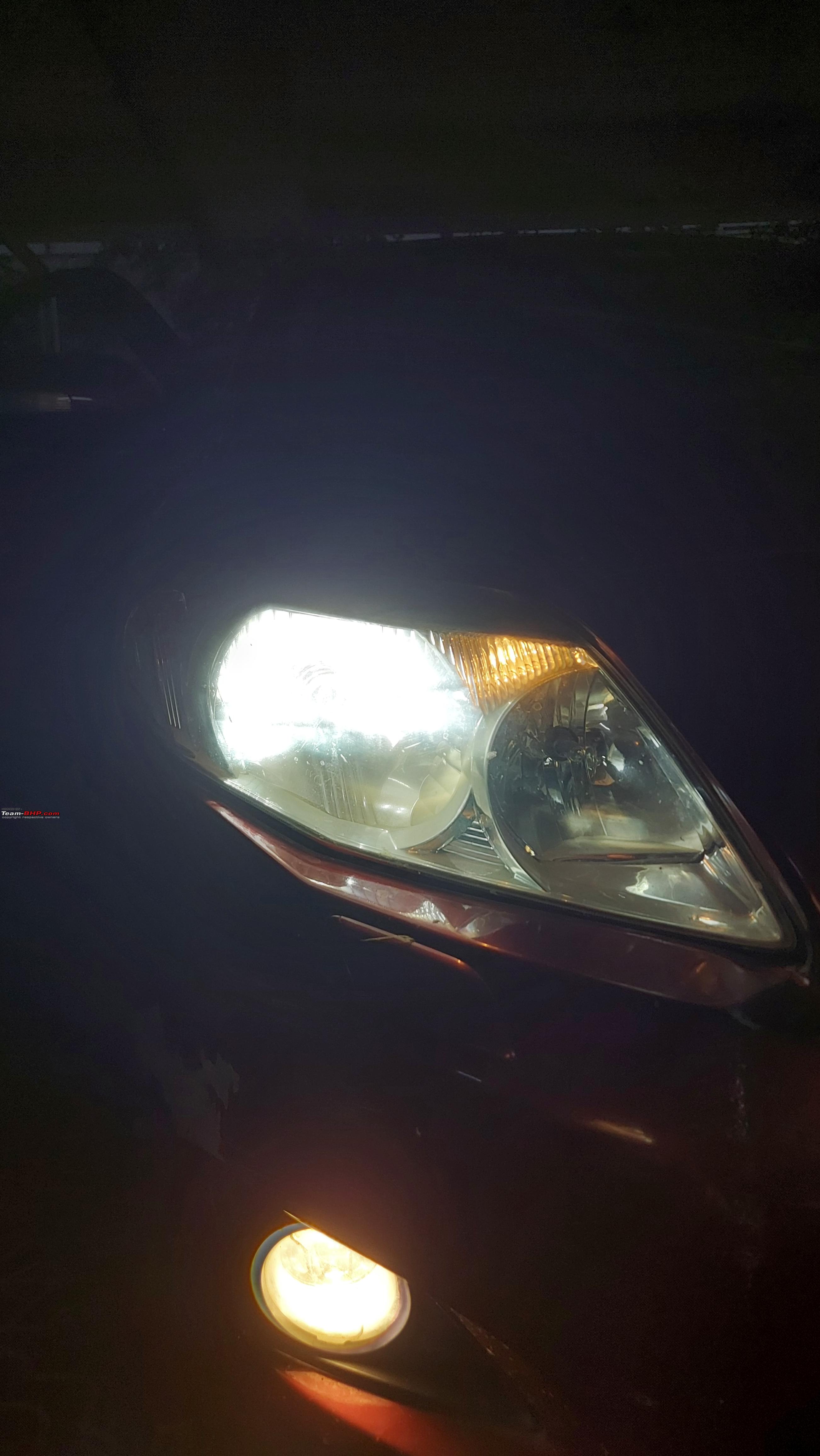

Recently upgraded both my headlights and foglights.
For the former i splurged and got a Philips ultinon for 6.5k.
You can get it cheaper on Amazon but i got it locally because i needed someone who could help with warranty claims given the cost.
On the other end of the spectrum, i got a pair of fogs from Amazon from a brand called fabtec for 1.5k. if you look at them or their performance, it's hard to believe one costs more than 4x the other. The fabtec has similar build quality, similar tech ( Philips/luxeon zes chips) and the light output is similar.
I got them mostly because my kids keep playing on the car, leaving the lights on and killing my batteries. Hopefully these will reduce that. After installing the headlight bulb i got them focussed at a nearby tyredrome and were able to achieve a sharp cutoff pattern and levels. Brightness levels are the same as my earlier bulbs which were 55/60 extreme power.
The fogs are a big improvement from the stock bulbs which were running generic bulbs. Also very surprised to see that they have the same brightness as the headlight bulbs.
I did not spend too much on the foglights as my car gets flooded in the rain every 2 years on average, and given that no dealer will cover water damage, I figured I'd get something cheap and cheerful and was pleasantly surprised.
I'm not touching the hella lights because I'm literally saving them for a rainy day
