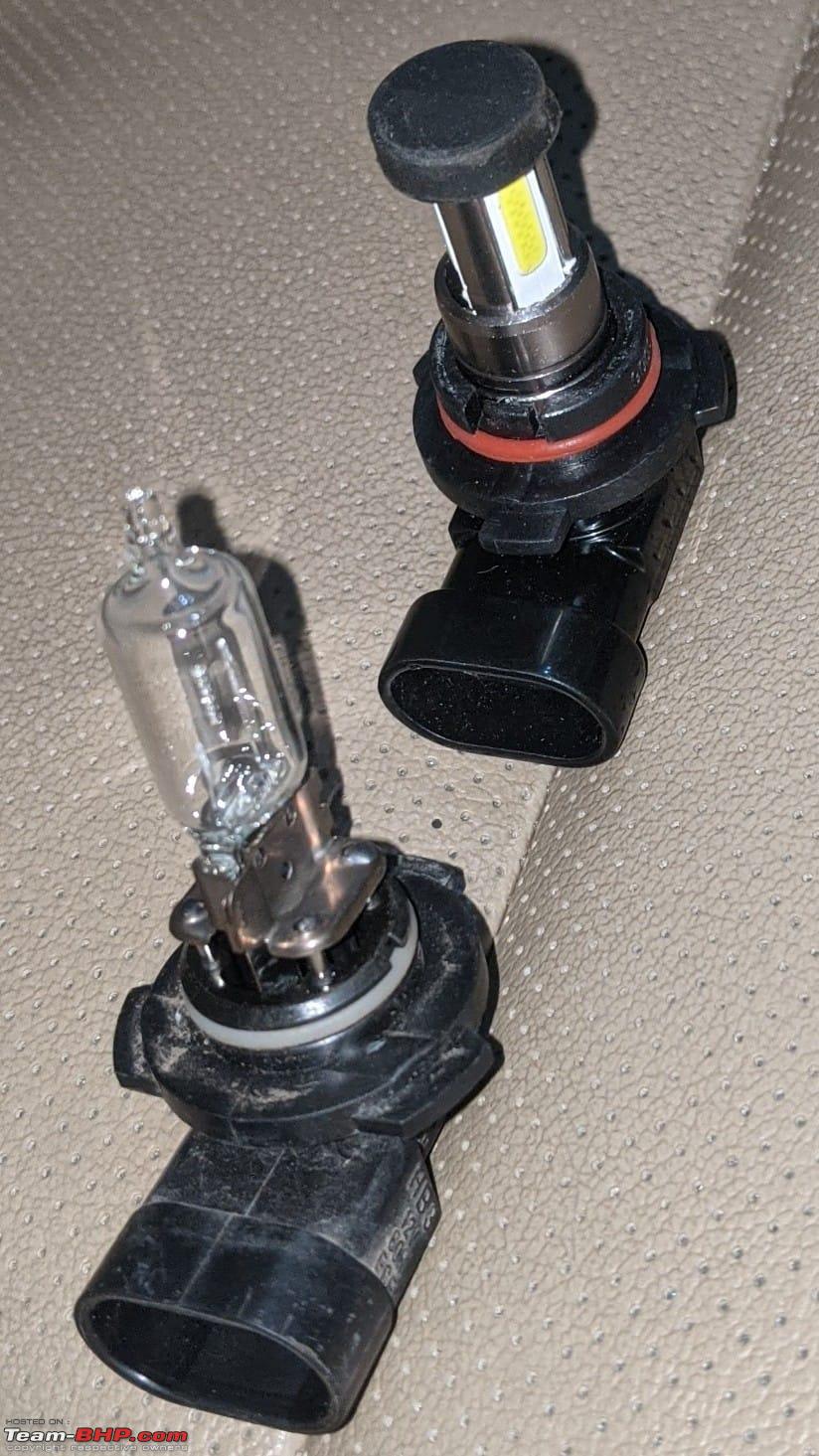

For my Toyota Yaris upper lights, I have ordered an H11 LED pair from banggood. However, the tabs are not aligned as the stock one.
Comprehensive guide to LED Headlight upgrades-f8bbe33b6e594a43a98577d4fc7e7bc0.jpeg

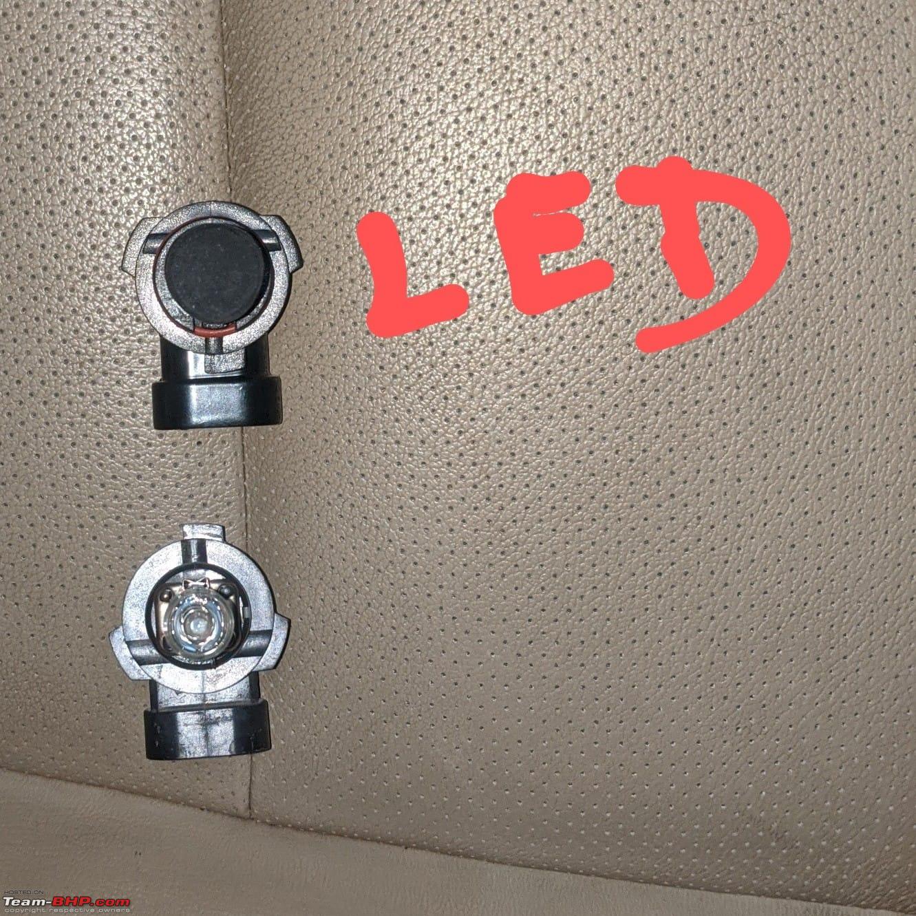

Is there any way to remedy this? The bulb/ slot tab appears to be snugly fit, and not easily rotatable. The bulb holder seems to be held up by three screws. Do I need to rotate the holder itself?
Comprehensive guide to LED Headlight upgrades-ccc378fa0a874f5ea2829e8ec53769f0.jpeg
Here's an angular view of the bulbs. There doesn't appear to be any tiny screw below the LED tabs to loosen them and allow me to rotate them.

I assume that the halogen bulb you have shown is the one from your car. If it is, then that bulb has a HB3 base. H11 and HB3 are different and are not interchangeable. What is the bulb base that is mentioned in the manual?

@Ani_meher - that LED bulb looks bad, it is going to ruin your night drives. Please swap with an 80W halogen and see if that helps.
