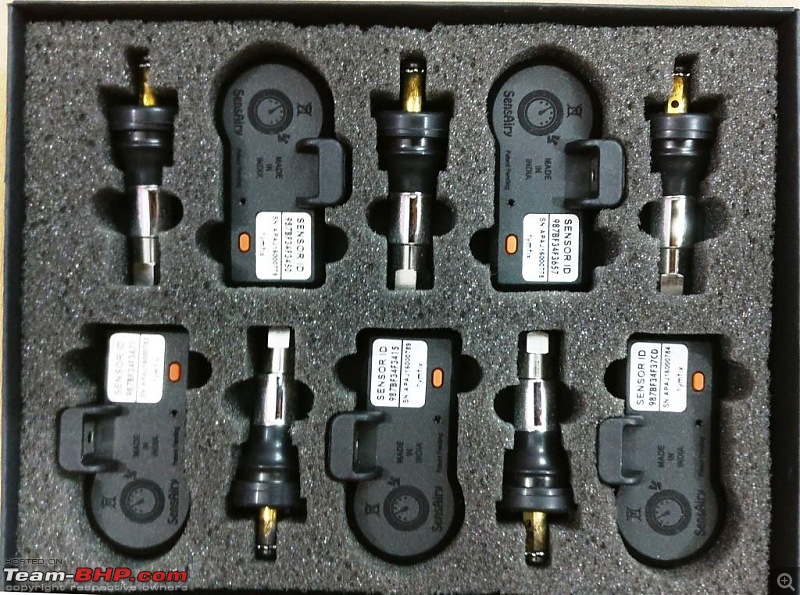

Contents:-

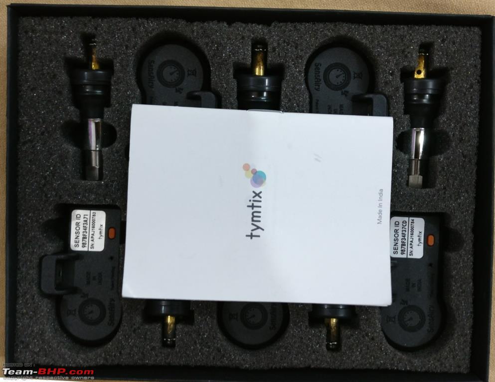

The packet had 5 valves and 5 sensors in it with a small leaflet clearly explaining everything.
SensAiry : An app-based TPMS-img_20170603_194735.jpg
Leaflet.

5 valves and 5 sensors.
SensAiry : An app-based TPMS-img_20170603_194753.jpg

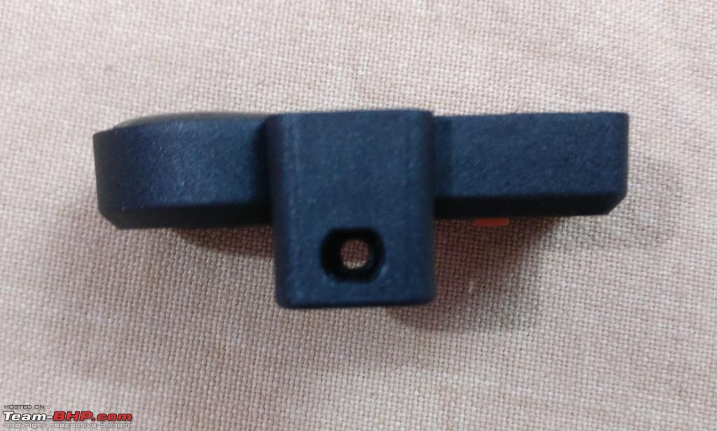

Other side of sensor which has to face the rim/alloy end.
SensAiry : An app-based TPMS-img_20170603_194814.jpg
The hole in sensor to fix the valve using the screw.

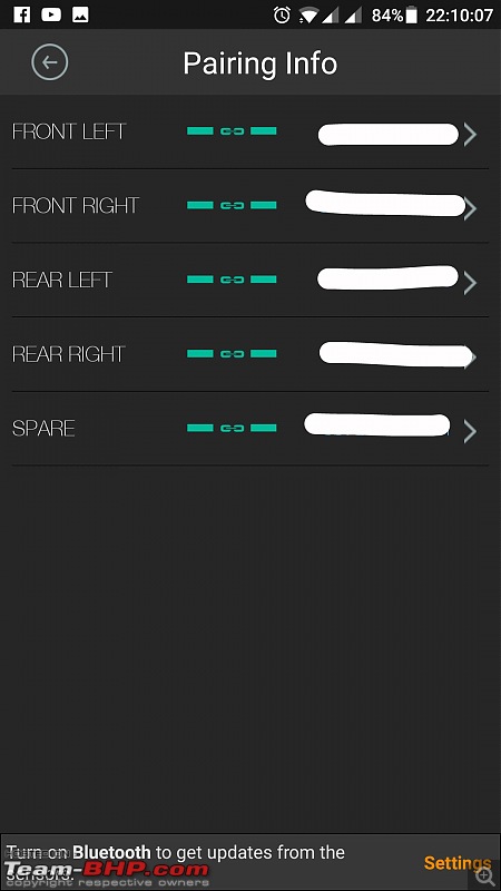

Firstly you have to create an account and then add a vehicle.
SensAiry : An app-based TPMS-screenshot_20170706222253.png
Then you have to setup the vehicle. A total of 20 tyres can be paired to a single account. Or you can add 4 vehicles with 5 tyres each or 5 with 4. In my case, its 5 tyres as my spare is also an alloy. They are in process of developing the same tech for bikes but its currently unavailable.
SensAiry : An app-based TPMS-img_20170706_221354.jpg
After pairing the device.
