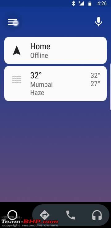

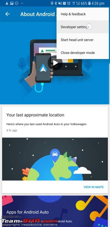

Android Auto usually blocks any external app, that is not part of the initial SLA of AA. To allow those apps, you need to go to Developer option of AA
How to:
1. Go to AA menu section
SensAiry : An app-based TPMS-1539774121854.jpg
2. Select "About"
SensAiry : An app-based TPMS-1539774235684.jpg
3. Keep tapping "About Android Auto" until you unlock developer options
SensAiry : An app-based TPMS-1539774250811.jpg
4. Go to the Developer settings
SensAiry : An app-based TPMS-1539774263552.jpg
5. Scroll to the bottom and enable Unknown Sources
SensAiry : An app-based TPMS-1539774288174.jpg
Let me know if this solves your issue. I was facing issues with Spotify on AA. This solved that for me.

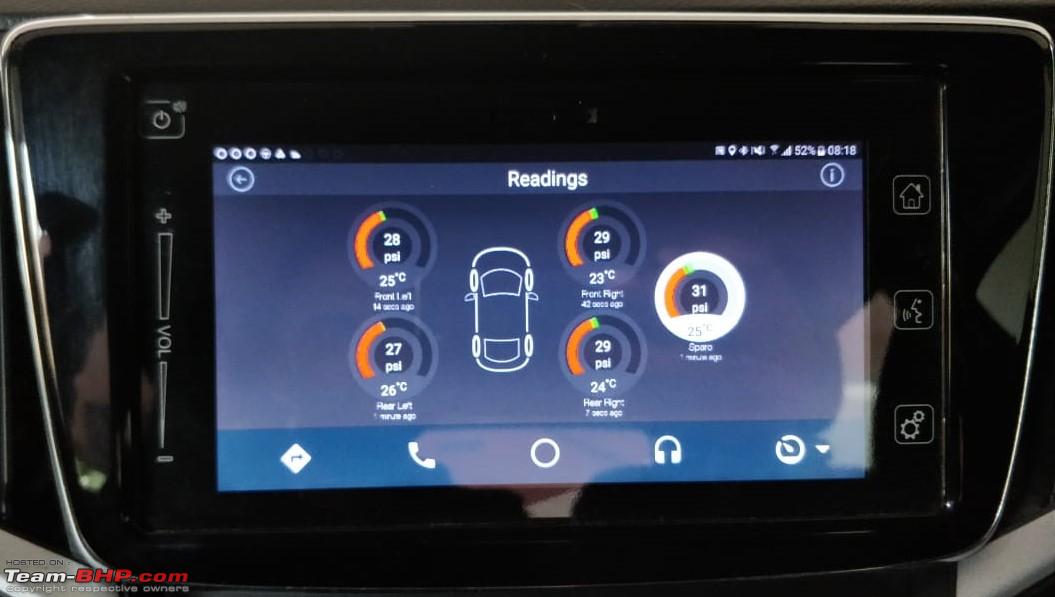

Yeah buddy! already done all the necessary setting changes before testing it out. As a last resort, my friend, who also bought SensAiry product recently and is able to mirror it on Android Auto in his S-Cross, gonna test using his smartphone in my Baleno. Let's wait and see for the result.
Found another way (hack) to mirror the screen on AA though
SensAiry : An app-based TPMS-sa-mirror.jpeg

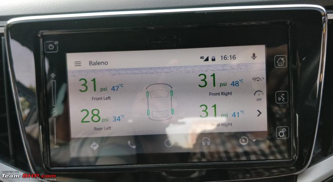

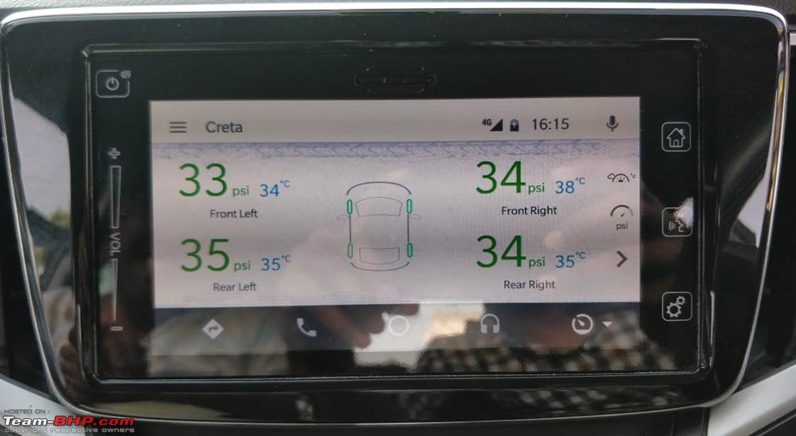

re: SensAiry : An app-based TPMS
Originally Posted by kskthere View Post
The only thing we forgot to check on that day is to test on my friend's S-Cross using my phone. That would have given clear idea.
Update:
Today tested in @a4anurag's Creta by connecting my OnePlus 5, SensAiry app couldn't mirror on Android Auto screen. When his phone was connected to my car's infotainment system, it worked using both his and mine SensAiry app credentials. So it is a clear indication that some settings on my phone denying the permission.
SensAiry : An app-based TPMS-sensairy-baleno.jpeg
SensAiry : An app-based TPMS-sensairy-creta.jpg
SensAiry : An app-based TPMS-sensairy.jpg
