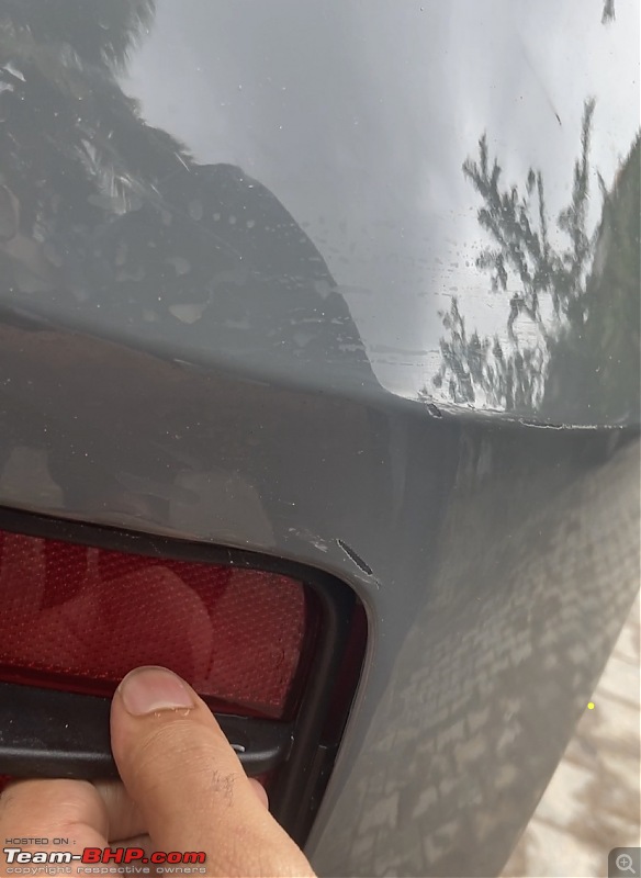

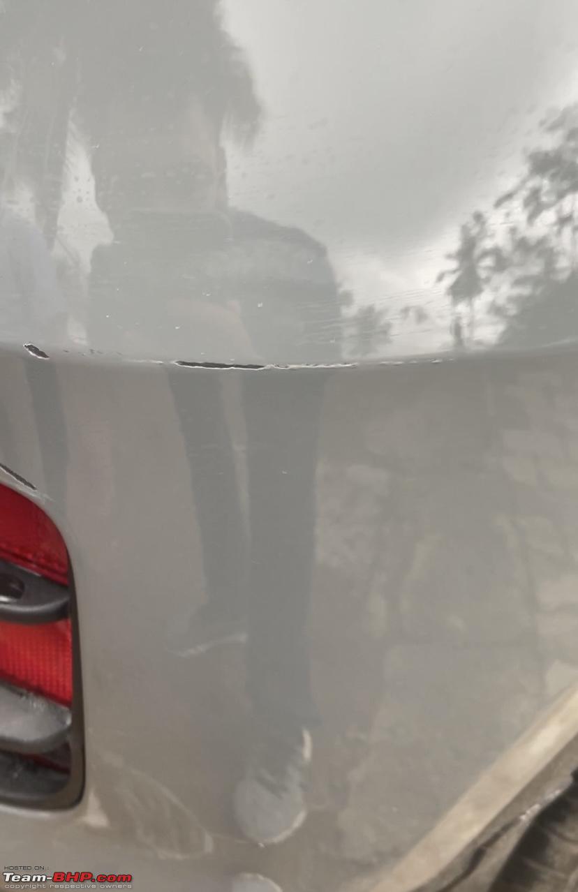

Hello AJ56
Got my new, 2 weeks old car’s rear bumper scratched by a biker
What should I do for this small a scratch.
There’s a parking light broken also, and service Center fellow said they’ll do a touch up after installing new light
1. What should I be vary of — better to do at a detailing shop?
I’m anyway going for a ceramic and PPF on both bumpers. (Either at Feynlab or Ultimate Detailerz)
2. Would a respray on such small area is not recommended? And given there will be a PPF over oh later, what kind of correction technique I should follow for this kind of a scratch?
3. Don’t know the exact process service Center will follow, but do they sand off a big patch and then spray over it?
Being my first ever car and getting a scratch like this with totally no mistake of mine hurts a lot :(
