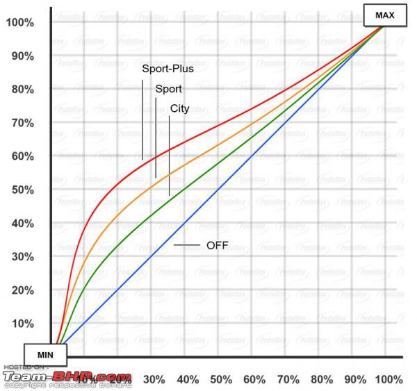

@Jaggu : Even the economy mode is supposed to have more response in this pedal tune box than stock. There is no mode lesser than stock here . I know the world "Economy" would make anyone think it's lesser than stock.
Logically power gain is not possible. But I think it can help in 0-100, in gear acceleration timing. On stock settings, the voltage rise graph is linear. But on pedal tune it's not linear, but it meets the stock graph at the end. So this doesn't lead to any dead zone on the pedal.
On 100 percent throttle, stock and pedal tune should be same. But yes, it's after you reach 100 percent throttle. Even if you have a heavy right foot, you could still accelerate linearly in stock settings. While the pedal tune makes it way faster.
Yes that might be specific for this device i guess (if you have measured it).
Again true.
Definitely it helps to iron out any rough spots of the stock map also then.
So in short we both are in agreement, it IS a great device to get a better driving car.
How much is the cost any idea? If it's thousand or two its major bang for the bucks!
