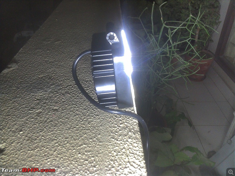

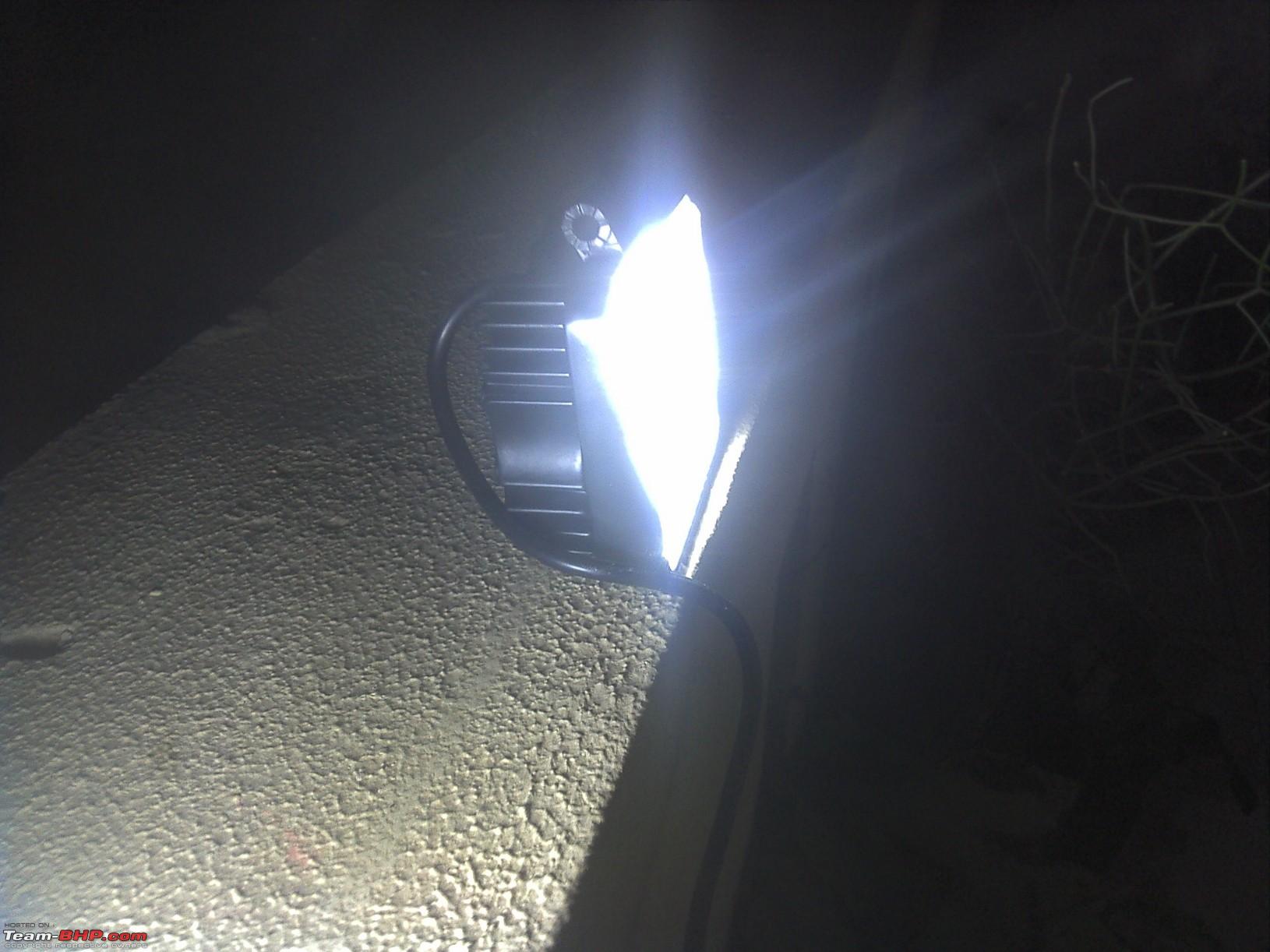

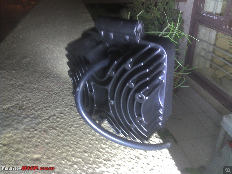

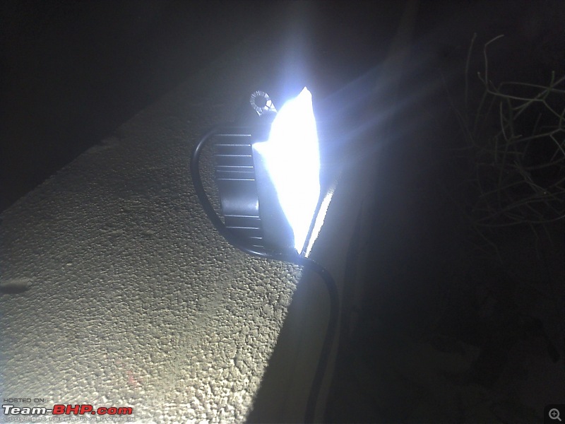

Below are some quick snaps of the LED AUX lamps that arrived today. There are 3W LED each total of 9 in each lamp with flood pattern. Spot beam is also available.
Review: 60W Cree LED Light Bar-wp_000558.jpg
Review: 60W Cree LED Light Bar-wp_000559.jpg
Review: 60W Cree LED Light Bar-wp_000560.jpg
I have hooked them to my inverter battery and will run them continuously for next 12 hrs outside to stress test them.

I also had one of these. I even drove them to 8W each LED. I think they went "poof!".
Frankly speaking, I was not impressed. The light is good for flood beam, but for range its totally useless.
I would go with minimum 10W LED. Ideally 15-20W LED with a good quality focusing lens would be awesome, but heat dissipation is an issue.
A 10W LED will give light output similar to the nitecore EA4 in high mode(actually little more than that at 700 lumens)
