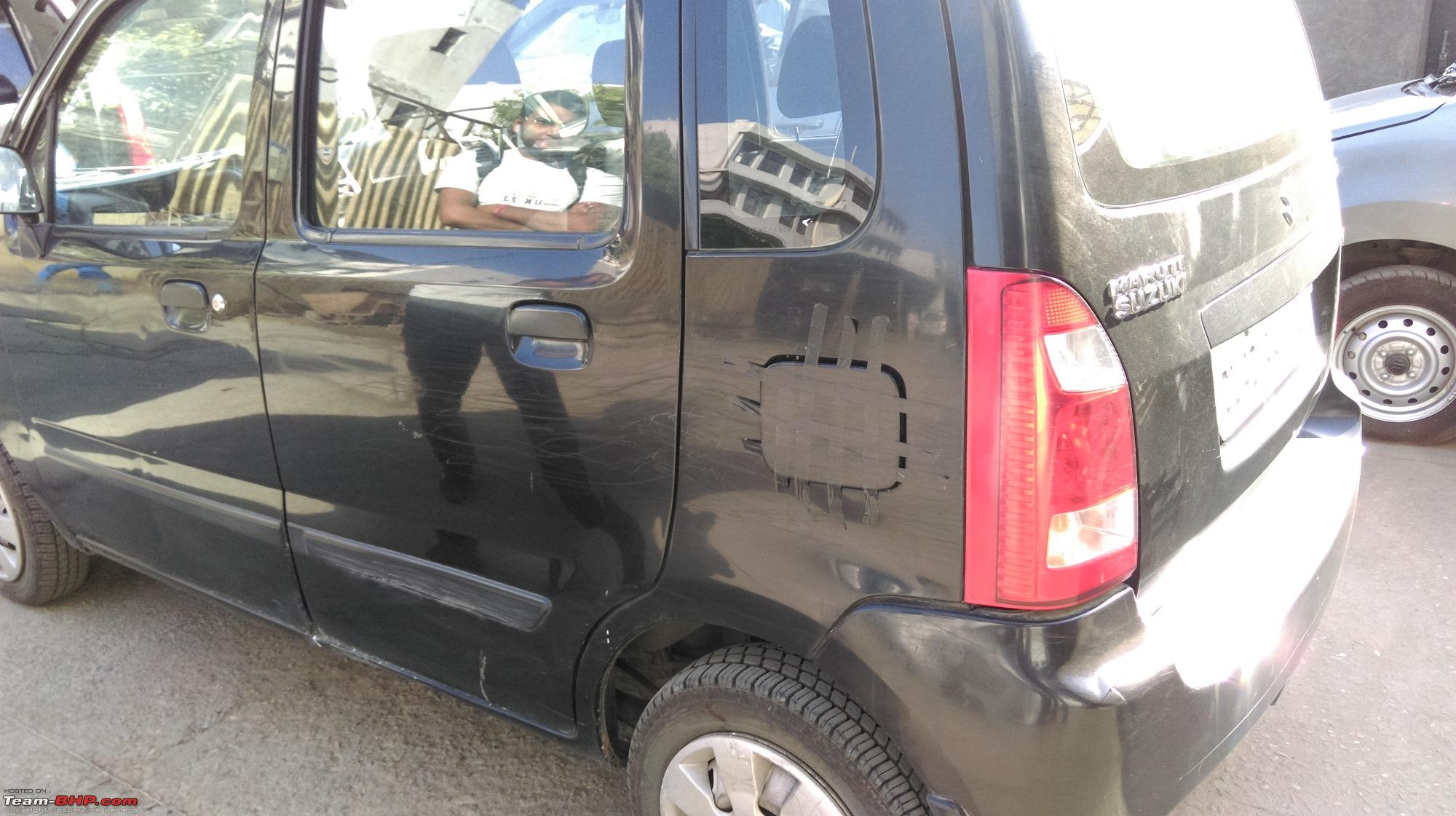

Also, my car's fuel lid cover was rusted and it fell off the place/joint where it is welded. I got the new cover installed from SVC but it was not in black color, I myself spray coloured the lid using com-paint and it looks as good as professionlly painted.

Also had a minor accident - first time in wagonr. Luckily nothing was major.
I was driving at the speeds of around 70 on NH1, just after entering Delhi there are couple of set of speed bumps(multiple speed bumps - not the conventional type of speed breakers).
Interestingly I was driving ahead of a Mahindra XUVs and another Mahindra XUV was following me.
Some 500 meters before the breakers, XUV ahead of me slammed brakes and I too applied brakes and changed gear to have engine braking assistance as well. But to my surprise, my car skidded a bit and got rammed into the XUV in front of me and the XUV behind me also rammed into my car.
Luckily by god grace, nothing happened to anyone except for couple of scratches on both XUVs. I should say XUV is a strong vehicle. Even after hitting the car at speed of around 30-40, nothing much happened. The XUV behind me was at bit higher speed because of that there was a dent on the tailgate along with one on my car's bumper.
Took the car to nearest denting/painting guy. Got the dent fixed both on the bumper and tailgate. Total cost Rs. 550.
This is the second time, I had an accident in my cars. The first one was in my i10 when it was hardly six month old. And now today in my WagonR.
In both cases, it could have been averted had there was bit more gap between the cars. Lesson learnt - no matter how confident you are on your driving, be more cautious and keep more distance between the car in front of you. Also I was bit sleep deprived and had lunch at Murthal. I could have managed braking a bit better. All tyres and brakes are totally new.
Anyways, my mood was bit off but later came home, cleaned the car, touched up couple of spots on the tailgate and took the car for an evening spin and then that's what my odo displayed.
Hope to have WagonR with me for more time to come and keep us safe.
Happy and safe driving.
