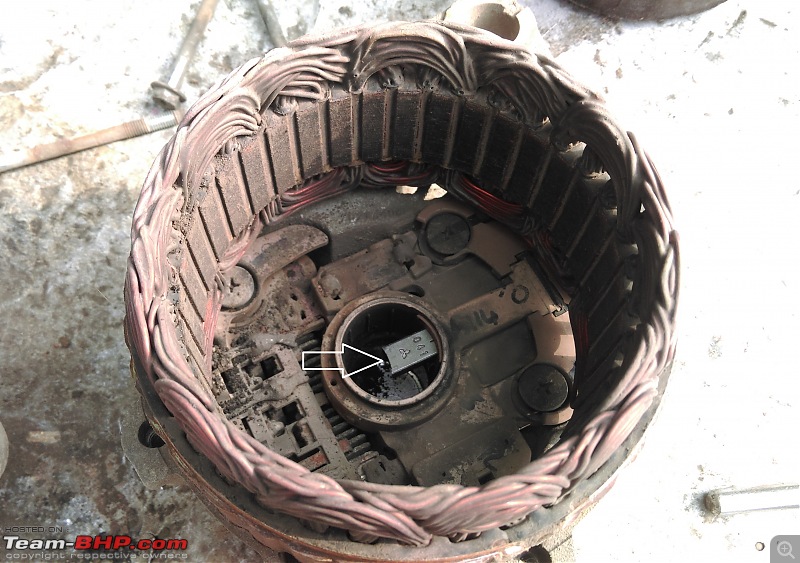

As I mentioned earlier about the intermittent glowing of charging light while driving and sometimes going off upon driving at high RPM, I got the problem rectified today.
Took the car to nearby auto electrician and he opened the alternator. Voltage was around 12.60 when the charging light appeared and it jumped to around 13.60 when the light went off upon acceleration. Usually the light used to go off when the car was driven for longer distances like more than 10-15 km but used to come again later next day.
There was no as such major fault in the alternator according to the servicing guy. There was a little part(see last pic, marked with white arrow) which he was referring as 'cut-out' has developed some problem which he fixed using some 'jugaad' (I don't know how he actually fixed it, but its ok now). This particular part cost Rs. 1500 according to him. And also he said that this alternator by TVS is also not available anymore because its discontinued by the company so I have to get it repaired only, new one will not be available.
Total charges = Rs. 400.
Voltage after repairing was around 14.25-14.30. Battery is ok. Current Odo Reading is 49160 kms. Battery will turn three years old in May, 2015 and my WagonR will be having its 8th Birthday in April, 2015 and as the car is ageing I am falling in love with it even more and never feel the need to sell this one to replace it with anything available in the market!

Good that the problem has been solved and also the battery is in good health.
One question, will the problem recur again or is it a permanent jugaad fix?
He has assured me that there will not be any problem. I will keep an eye on the indicator. Rest, let's hope it stays ok.

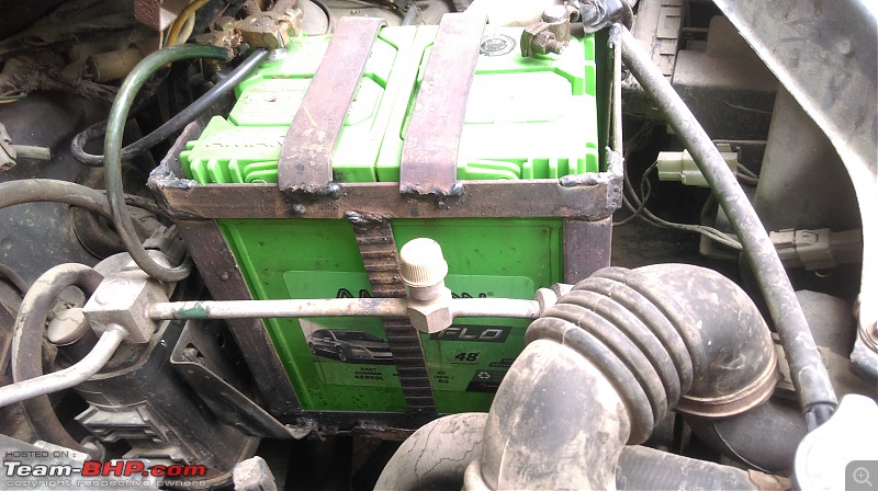

Someone stole battery of my car last week by force opening of the bonnet and my 3 year old amaron battery was gone. It must have worked for at least one more year. In the morning, my dad tried to unlock the car but there was no response from the remote, we thought the remote's battery got conked off, unlocked the car using the key and tried starting but heck the car's battery was gone!
Bought a new Amaron battery for Rs. 3300 + got a custom security case built for battery protection in future for Rs. 500. Battery mechanic told me it is quite easy to force open swift and wagonr's bonnets and there are huge number of battery theft reports from these cars, so he recommended to install a case for battery protection.

So how do you take out the battery if you need to ?
And would you leave the metal exposed ?

In delhi, stealing of batteries from cars and even bikes is pretty common incident these days. In my locality, I have seen 4-5 cases personally & out of them were my neighbours wagonr and swift involved only. My battery guy told me it is very easy to force open the bonnets of wagonr and swift. The hook which locks the bonnet is attached with a rod that is accessible through the front wheel open area and a little bit of fiddling around and the bonnet is open without actually breaking anything.
The case will be removed by the welding guy only. I hope there will be no need to take out the battery at least for next 3-4 years till the time it runs out of juice.
The metal will be like this only, though I have applied jelly on battery terminals.
