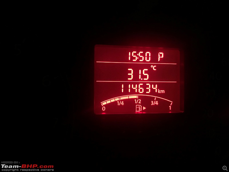

My car is now 8 years old and ~115,000 km on the odo. Not bad for a petrol automatic eh? In retrospect the choice of engine, gearbox and fuel have been perfect. The 1.6L naturally-aspirated petrol engine is no stonker like its TSI equivalent but since it is mated to a 6-speed torque converter instead of the dreaded DSG, am spared any "mechatronics failures". Plus, it's a petrol so no "Dieselgate" impact. 2010-12 TDIs are infamous for their unreliability but no such issue with the petrols.

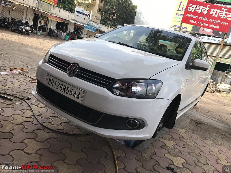

With early monsoon showers setting in, thought my baby could do with new shoes. The current set of Yokohama Earth1 tyres had served me well. I changed last almost 4 years/50,000 km ago.
Decided to go with Metro Tyres, Pimple Saudagar this time (my usual place is Lokmanya Tyres). Confirmed with Rizwan that he has 195/60R15 options in stock. This size seems perfect for the Vento.
It was between the Continental CC5 and the incumbent Yokos. Truth be told I have no complaints with the Earth1s. They are made-for-India tyres and offer a good mix of comfort and ruggedness. I have had far fewer punctures with this last set than with the previous Yoko dBs, which were too soft for my kind of usage.
Took about an hour to get it done: Metro is competent, fuss-free and pretty good. The only delay was thanks to the Saturday afternoon crowd.
Total damage was some 23K for a set of 4 Yoko Earth1s.
