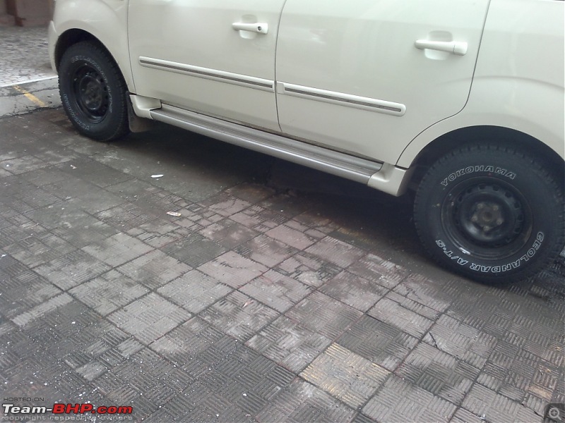

Tyre Change:
First do refer: http://www.team-bhp.com/forum/tyre-a...ml#post3226345
My initial decision for tyre was to go with same specs as stock: Bridgestone Dueler AT 215/75/R15 (100S). After all it lasted (or somehow served!) me for 80K+ KM.
After running the newer suspension for few days, one day I went to Best Tyres (Vashi). Unfortunately, they had only 3 qty. I kept following-up the dealer, but couldn't get the 4th one. Even checked with other BS dealers in different localities, but price quoted was bit higher (6500-6800).
Meanwhile, @mantrig (Gaurav) called & updated me of his change: Ceat @ ~5500, which suited his requirement of low usage of vehicle. My pending task was pinching me, and one day I prepared myself to get done even at 6500. For me each passing day was crucial, for the upcoming Kutch trip with family in W1-Nov13, and less time because of my official work & trips. Using JustDial service, spoke to few BS dealers and finalized at 6500 with one in Vashi; even he spoke of rise in BS prices since few days. Evening I started from office to go this dealer's place. Now the interesting part starts !
On the way from office, daily I cross a big tyre dealer. Reading their name plate, I realised of not calling them upon getting their contacts from JustDial! Infact, just few days back when I was returning at night, I had borrowed a spanner to fix the relay wire to battery terminal. (the engineer at workshop forgot to put the relay connecter back on terminal, which initially I thought of kaput bulb!). Hence I went inside this shop: Sanghi Tyres (https://maps.google.co.in/maps?ie=UT...ed=0CDUQrwswAw )
The people were nice to speak, and quoted me Rs.6500 for BS specs, which anyways I agree for. Now, I actually forgot of the dealer whom earlier I had finalized on phone, sorry.
Further Sanghi offered a better quality, at a bit higher price. Guess what, he spoke of Yokohama Geolander ATS @ Rs.6700. Friends, this was the turning point. Just a difference of Rs.200.
I asked him to give me bit time, and immediately called a Guru - Mr.HVKumar. HVK was kind enough to discuss at length on this topic. His overall opinion of BS was good, but Yoko was far better. His main parameters were: handling & braking, with lesser importance of longitivity of tyres. He even appreciated that if my current BS have served for 80+KM, that too with my irregular maintenance (alignment, balancing, rotation), the BS would have done even better. He voted for Yoko, which are a bit softer and tend to have bit lesser lifetime than BS. My decision was changed, it has to be Yoko. I negotiated with Sanghi and finalized at 6600 per piece, including alignment & balancing (later I paid Rs.450 for Lead weights), and chrome-look valves. HVK advised me to maintain the tyres, and increase the air pressure by 2 points than BS, to maintain the stiffness against softer material, otherwise warned of immediate drop in mileage. (this happened, details later).
HVK made a point (best practice) of changing the all tyres every 3 years, whatever the condition. My spare one is still BS, which I will change to Yoko after 2-3 months (vitamin-M adjustment).
Got the new Yoko tyres installed. The older ones were offered for buy-back, which I pushed to later date and put inside my vehicle. Dealer gave proper bill and Yoko warranty card, along with two keychains. (they charge extra 2% on my credit card, since I didnt have cash, which was OK). Overall, good people to deal with.
total Cost = Rs.27300
some pictures (wheel-caps were removed temporarily):
Mahindra Xylo E8 (ABS): Spacious, feature-packed, 8-seater is here. EDIT: 340,000 km up-20131011326_new.jpg
Mahindra Xylo E8 (ABS): Spacious, feature-packed, 8-seater is here. EDIT: 340,000 km up-20131012327_new.jpg
Mahindra Xylo E8 (ABS): Spacious, feature-packed, 8-seater is here. EDIT: 340,000 km up-20131012328_new.jpg
Mahindra Xylo E8 (ABS): Spacious, feature-packed, 8-seater is here. EDIT: 340,000 km up-20131012329_new.jpg
Mahindra Xylo E8 (ABS): Spacious, feature-packed, 8-seater is here. EDIT: 340,000 km up-20131012330_new.jpg
Mahindra Xylo E8 (ABS): Spacious, feature-packed, 8-seater is here. EDIT: 340,000 km up-20131024333.jpg
Mahindra Xylo E8 (ABS): Spacious, feature-packed, 8-seater is here. EDIT: 340,000 km up-yoko-warranty.jpg
The ride was superb and handling was terrific. Firstly it took me with excellent surprise - imagine a guy running on busted tyres since months, now given two shots of lifelines: fresh suspension and fresh tyres :-)
At my regular station, got the tyres filled with Nitrogen (my BS were also mostly on NO2). Normally, the guy just deflats air on stationed vehicle, which increases momentary pressure on tyres. To take extra care of new beauty, I paid bit extra to first jack the vehicle and deflate air from each tyre and then fill Nitrogen.
But within few days I realized of lower mileage, the fuel bar at 3/4th where it earlier took me for ~190 Km, now returned ~150 KM. To reconfirm, I did diesel top-up again and the results were same. Even visually, the new tyres were looking slight pressed. My BS used to have 34psi, but cant comment on the accuracy of various filling points.
Fast forwarding few days, just to speak focussed on the tyre matter: two days back, went to Sanghi and finally sold the 4 old tyres for handsome Rs.1500 (says 2 are totally busted), and got air pressures to 36. The ride is still good, but yet to measure the mileage.
