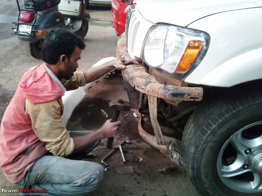

Hawk-On-Fours® (H-4®) with a tail - Scorpio mHawk 4WD EDIT: Sold!-20131223-07.15.44.jpg
With that number on the odo, H-4® does not need to go to a M&M ASC compulsorily any more to maintain warranty. So it was taken in for a routine service with oil and filter changes to my usual FNG. 6L of Shell Helix HX6 Diesel cost me Rs.1480, oil filter for Rs.120, air filter at Rs.450, Bosch diesel filter cartridge Rs.850, followed by a whopping labour charge of Rs.200!
The front bumper was misaligned after occasional brushes with unruly traffic over the last 4 years and more, and needed a little straightening and touching up. It being a drizzly, cloudy day, painting was out of the question, so I had the painter, a chap by the name of Badal, open the bumper up to align the subframe.
With evidence of substantial rust on the subframe, it was time for some emery paper and 'Black Japan' to be brought into action. The final result: a straightened bumper, and peace of mind that the insides are rust-free! The fog lamps were also cleaned out, and now look nice and bright. Set me back by another princely sum of Rs.500 for the work.
Hawk-On-Fours® (H-4®) with a tail - Scorpio mHawk 4WD EDIT: Sold!-20131227-15.15.13.jpg
Hawk-On-Fours® (H-4®) with a tail - Scorpio mHawk 4WD EDIT: Sold!-20131227-15.46.42.jpg
Hawk-On-Fours® (H-4®) with a tail - Scorpio mHawk 4WD EDIT: Sold!-20131227-16.35.09.jpg
Hawk-On-Fours® (H-4®) with a tail - Scorpio mHawk 4WD EDIT: Sold!-20131227-16.44.12.jpg
Need to go back on another sunny day for the paint to be touched up and for a bit of rubbing and polishing.

Finally, the evaporator is out - corroded in multiple areas, due to moisture remaining stuck to the body, thanks to the foam insulation along its sides and top. Seems corrosion damage is a common problem with the Scorpio's evaporator, after 4-6 years of use. Surprisingly, the fins were quite clean even after 5 years - obviously, the AC filter works very well, especially when the system is permanently in recirculation mode as mine is.
Hawk-On-Fours® (H-4®) with a tail - Scorpio mHawk 4WD EDIT: Sold!-ac-11.jpg
In goes the new evaporator...
Hawk-On-Fours® (H-4®) with a tail - Scorpio mHawk 4WD EDIT: Sold!-ac-12.jpg
...followed by 650 grams of R134a, plus 150ml of compressor oil. And all is well by about 8 pm - roughly 8-and-a-half hours after work began.
Cost incurred: Rs.9,400, including Rs.5900 as the cost of the original Behr evaporator.
