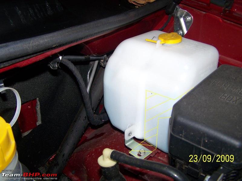

Here one more update. Before my Trip to Mahabalipuram, I had noticed a leak in the windshield water tank (again) and decided to get it rectified after coming back from Concorde, Mysore road. I was clocking around 22k in the Odo.
Took help from HW as this was the second time it leaked to see if a newly designed tank has come out and vola, mine was an old one with the clamp arm fixed on one of the sides of the tank and used to leak from the clamp rubbing against the plastic.
Old clamp depicted by yellow lines. New one as in HW's safari.
This is the new design, which I insisted for, although it took some time to procure it but well worth, in the meantime they also found some issues with the clutch too and I went for replacement, during the wait for the tank spare, also noticed some other things and went for their replacement too. Therefore these were the jobs done.
