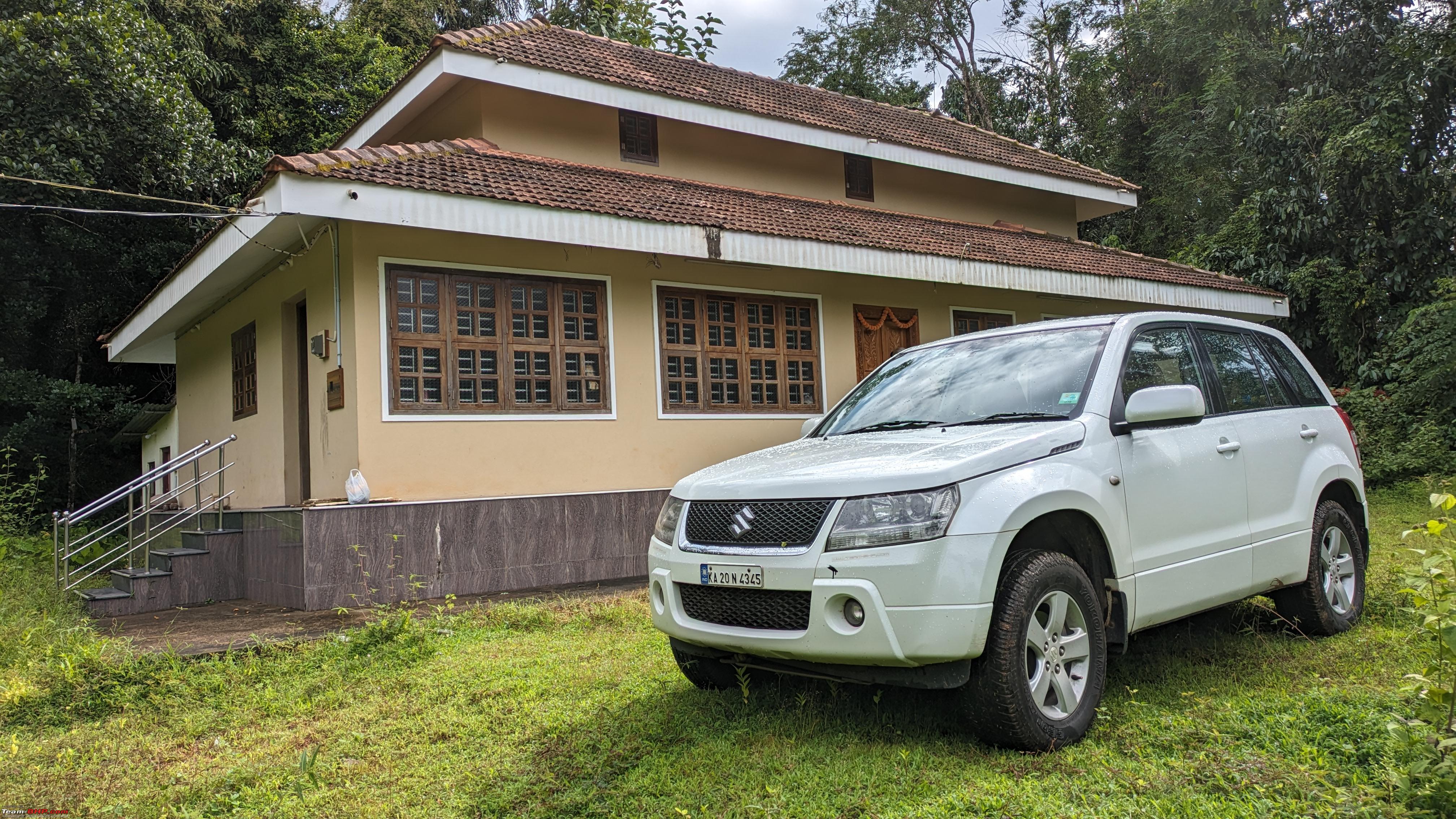

Picked up the car today from workshop. The radiator, O2 sensor and brake pads replaced. My friend at the Maruti workshop was wondering whether the whole ruckus was started by a faulty fan motor. If it had stopped working temporarily, it would have caused higher temp, thus higher pressure, leading to radiator core burst and spraying of predator blood. Plausible theory. I have asked for the price of the fan motor, if it is cheap enough, we will replace that too.
Other than that, the AC gas was topped up, HSRP installed, reverse camera reinstalled, and regular service with oil change was also done.
Looking clean and ready after a two weeks hiatus.
