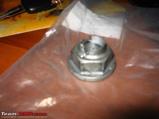

Originally Posted by shibujp View Post
Got a 30k service done on my Swift diesel at 33k actually . I had changed the oil at 30k (3 litres of Mobil Delvac Super 1300.) Cost me 1100/- (540 for the oil and 525 - oil filter + labour)
He said these were the hub nuts that had to be removed for the brake overhaul. They are punched in at the company and at the service center they have no option but to replace them it seems. Said it was std practice for the Swift.
The Mobil works great. After the oil change the car felt smooth.
Drive on!!
Shibu.
Hub nuts i have a feeling the service guys are pulling a fast one, maybe it accidentally broke, when they tried to remove em, can happen due to rust et all.
Where did you get the super 1300? Difficult to come across in BLR :(
Posted a picture below of one of the replaced rear hub nut in question. Will check out if this is changed again for the next brake overhaul. Part no : 09159 - 18022. To be fair the supervisor did say that they could have perhaps use the same one but did not want to take the risk of the nut slipping.
I have not had a problem getting the Super 1300 so far the two times I've gone shopping for it. I get it from a lube shop here at Trivandrum.
Nope i dont have this part billed, and good that they replaced it otherwise it would have been a problem next time around. Its a small part, minimal cost dont worry too much.
