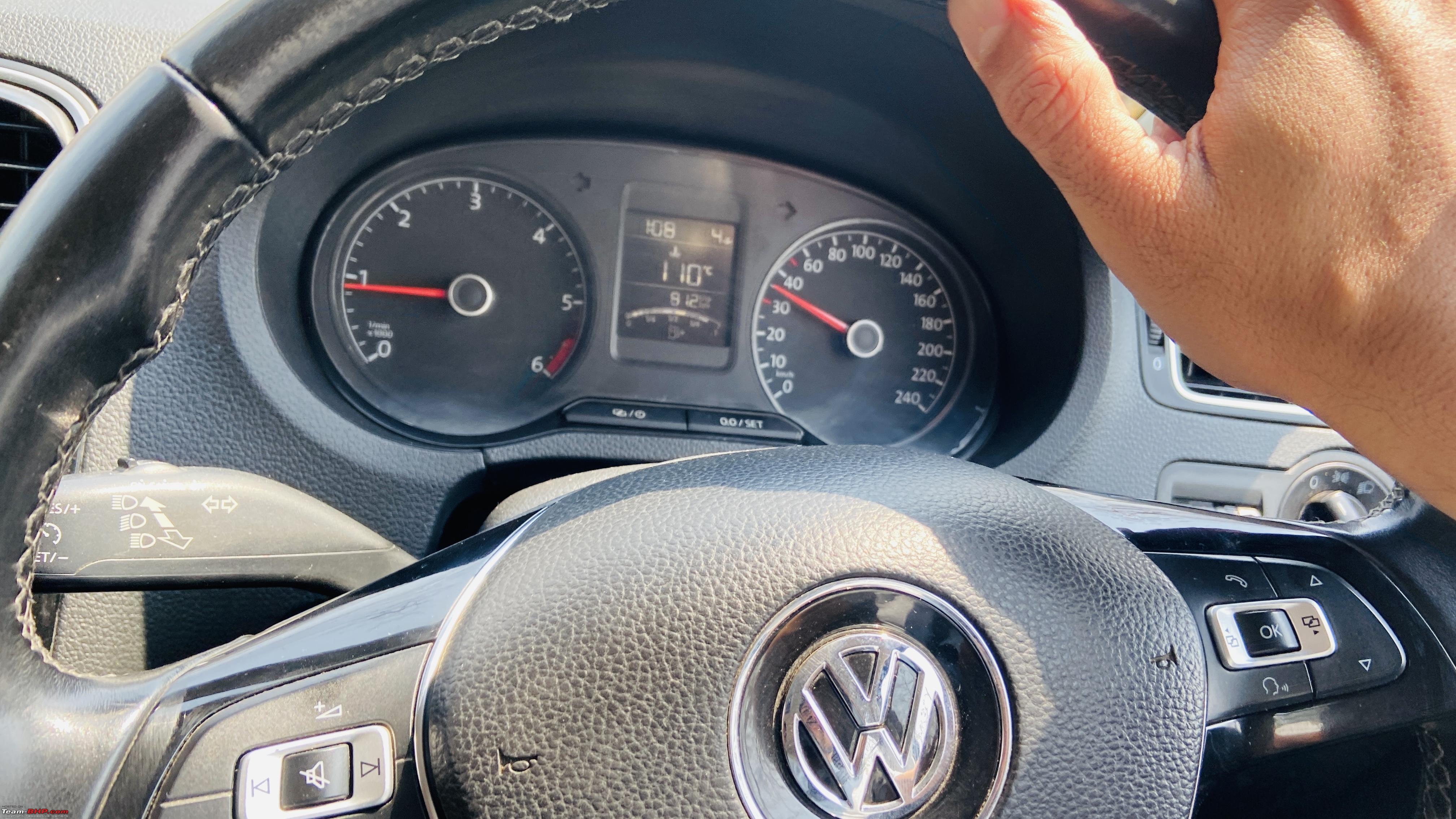

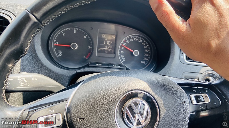

1) During one of the weekend drives, I noticed the engine temperature climbing up to 110 degrees, after a session of spirited driving, and would settle back to 90, quite immediately once I'd stick to speeds between 60 - 80 kmph. The first time it happened, there were three well-built individuals in the car, outside temp was 40 degrees, and the AC was on full blast. The second time I tried replicating it, I was the only one in the car, outside temperature was again 40, and the AC was set to 21 while I drove the car on some B roads, not overtly, but slightly enthusiastically.
Is this normal TDI engine behaviour? Because I'd never driven before with the display set to show the coolant temperature. I've also started noticing that when the temperature shoots beyond 100, the engine isn't as eager to rev as it does when the temperature's below 90. The coolant level is at the optimum mark and I haven't noticed any drop in levels. Air filter too is about 3k kms old and the car runs a cold air intake outlet.
Attachment 2739098
Hi Karan, first of all, congratulations for your new beast, POLO GT TDI is one hell of a car and I’m so happy that you found such a clean example.
Coming to your query on coolant temperature, I have driven my Rapid TDI for 1.15L kms and no matter how I drive it, the coolant temperature has never risen above 90 C. The only time it went to 95 was when we were performing coolant flushing, that time the car was running on VW Coolant Flush kit, the liquid was provided by VAG itself, we did a 20km test run and that’s when the temperature rose but after cleaning the system and refilling with coolant, the temperature got back to normal. If it’s rising all the way to 110C, there’s definitively something wrong. You may want to check the followings-
  • Coolant leakage
  • Air bubble in the cooling system
  • If water pump and timing kit replacement was done properly
  • Correct Coolant Mix was used
Please update once you do the troubleshooting.

Thanks Sachin. It always stays at 90 within the city even after a couple hours of driving in jam-packed traffic. It’s only after a few hours of driving is when the temps shoot up. Trying to diagnose
Just wondering if the fan is switching ON and/or the thermostat is woking fine to let the hot coolant circulate properly through the radiator to cool it down.

In case of my remapped Polo 1.5 GT TDi, the MID always shows 90 degrees. But the obd reader shows different readings. Mostly the obd reading is around 96-100 degrees and it climbs up to 105 when climbing ghats or when pushing the car to the maximum.
It only happens when the car is pushed to the maximum or is being driven uphill at a slightly higher speed. Should I still get those things checked?
Maybe my car’s MID is as good as an OBD. Because it does climb up to 105 and 110 when pushed to the maxium or clinbing ghats enthusiastically. Things do stay at 90 during normal driving conditions.
