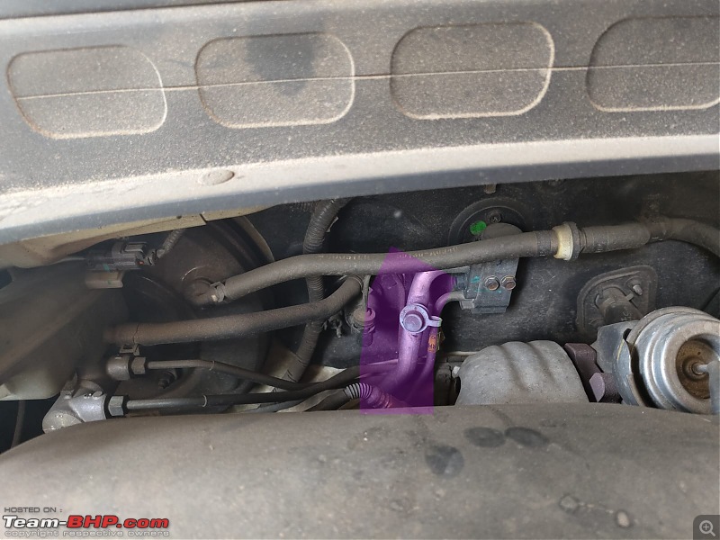

I do have a question for you. Last week, I had this long drive. AC cooling was fine, but the amount of air sort of started to decrease, but fan sound was there.
After driving for around 2 hours, opened the bonnet and this pipe was frozen (image attached).
5+ years with my Hyundai Creta | Ownership Review-whatsapp-image-20221226-11.14.09.jpeg
On reaching the next city, switched off the car and checked with the passerby on the nearest hyundai dealer. Got the place and while driving, AC was working fine. Checked the pipe and it looked normal. Sort of a defrost happened when I switched off the car. Didnt bother to get it checked. Worked fine for an hour and it slowly started to decrease - Same issue.
But on our return drive (3 hours) with fulltime AC, it was normal. What could be the reason?

I do have a question for you. What could be the reason?
Thank you very much for your kind words of appreciation. It means a lot coming from you since your reviews of your Creta were some of the first that I had checked out during the initial days of my research in 2016 before getting my car in 2017. Your Creta's 1.6 diesel engine is by far the best performer amongst all first-generation Creta and hence your decision to hold on to the car is completely understandable. Moreover, as the saying goes, they don't make them like that nowadays
About the temporary issue with your car's air conditioning, sadly, I am unable to reach a definitive cause. However, I can make a few speculations as to what might have caused the issue. Since the issue got fixed by itself, we can rule out any refrigerant gas leakages. Here are my speculations in no particular order :-
1) the block-style expansion valve of the compressor may have been stuck open and the shutting down of the engine somehow managed to dislodge and reset it. This is quite a rare occurrence.
2) maybe the cabin air recirculation mode was off or the diverter vent flap did not close properly due to dried mud, etc. At the same time some road debris like dry leaves, a piece of paper like a leaflet, etc got stuck within the air duct for the sirocco style blower fan for the AC. The best way to confirm this hypothesis is to check the AC air filter where the remains of the debris would have accumulated.
3) the thermistor inside the cabin is another aspect that can go wrong and this is apparently a not-very-uncommon problem in Hyundai vehicles where some cabin air fresheners, perfumes, etc cause the thermistor to get damaged and send wrong cabin air temperature readings to the AC control module. I hope that this is not the situation in your case or else you might have to replace the thermistor.
4) sometimes debris (usually disintegrated rubber gaskets/seals) from somewhere within the AC system manages to get dislodged and gets stuck inside the evaporator coils resulting in ice formation caused by blockage. As per mechanic accounts, this was apparently seen in some initial batches of the first-generation prefacelifted Creta. I hope that it is not applicable in your case as that would mean an expensive replacement. The part itself is not that expensive compared to the labour charges involved since the entire dashboard has to be opened up to access the evaporator coils. I know all this because I administer a Facebook group about the Creta where some of my fellow members have faced this issue.
These were some of the reasons/explanations/speculations that I could come up with. I hope that the issue that you faced was just a random electrical gremlin and is somewhat unlikely to occur again. However, please let me know if it occurs again. Also, kindly check and clean the AC air filter. I hope this helps. Keeping my fingers crossed.

I also have a 2018 SX(O) Auto Creta petrol and I have mentioned this problem I faced with the air conditioner and this is what happened.
I was driving in the evening in Bangalore and the AC became very cold at around 22 degrees on the knob on Auto mode. So I turned it up to heat the cabin to 30, still it was cold. Then I switched it off.
When I reached the place I needed to go, I did what I need to do and came back and restarted the car and still it was cold. So I switched off the AC completely and went home.
The next day, in the morning hours, I went for another drive and the AC then was not cooling at all. So switched off and opened the window and drove and went back home.
The day after, I took it to a Bosch service center and we both sat in the car and tested. Worked perfectly in cold and heating perspective - we tested both ranges of the temperature for well over 30 mins and worked perfectly.
I then had the AC unit and filters etc cleaned as I was going on a long drive the new couple of days. Full AC drive for more than 400 kms one way in a coastal region with 4 people in the car, no complains from the cooling perspective - it has not come back again till now and its been more than two months since I first noticed the issue.
I really wonder what caused it to behave in the way it did.

There is a sensor sitting on top of the cooling coil , that sensor is probably on its way out. Sensor in itself is rather inexpensive but you do need to remove the whole dashboard to access it. Hyundai makes it's interior bits very well so even after a full dismantle session and refit nothing would creak or rattle.
