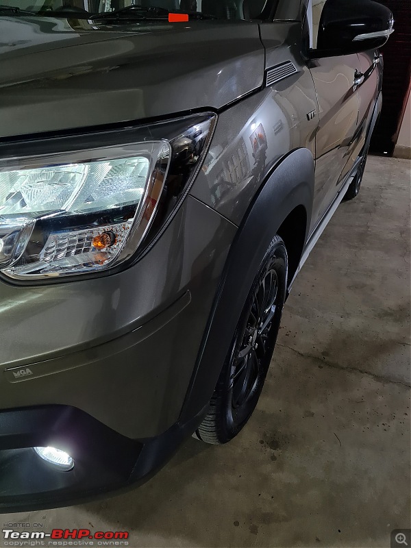

Some pics:
Extremely dirty car:
My first car: 2020 Maruti Suzuki XL6 Alpha MT Review-20210619_101745.jpg
My first car: 2020 Maruti Suzuki XL6 Alpha MT Review-20210621_074246.jpg
My first car: 2020 Maruti Suzuki XL6 Alpha MT Review-20210621_173229.jpg
My first car: 2020 Maruti Suzuki XL6 Alpha MT Review-20210621_173246.jpg
Reflections post polishing:
My first car: 2020 Maruti Suzuki XL6 Alpha MT Review-20210621_195212.jpg

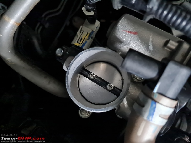

For me, internal health is more important than external looks:
My first car: 2020 Maruti Suzuki XL6 Alpha MT Review-20210622_151818.jpg
TB had a bit of carbon accumulation around the edges:
My first car: 2020 Maruti Suzuki XL6 Alpha MT Review-20210622_151823.jpg
TLC in progress:
My first car: 2020 Maruti Suzuki XL6 Alpha MT Review-20210622_175846.jpg
My first car: 2020 Maruti Suzuki XL6 Alpha MT Review-20210622_175931.jpg
Engine bay was cleaned and detailed too:
My first car: 2020 Maruti Suzuki XL6 Alpha MT Review-20210623_192037.jpg
Aftermath:
My first car: 2020 Maruti Suzuki XL6 Alpha MT Review-20210625_102615.jpg
My first car: 2020 Maruti Suzuki XL6 Alpha MT Review-20210625_102702.jpg
Well it will certainly get dirty again, but that's the fun of a car ownership!

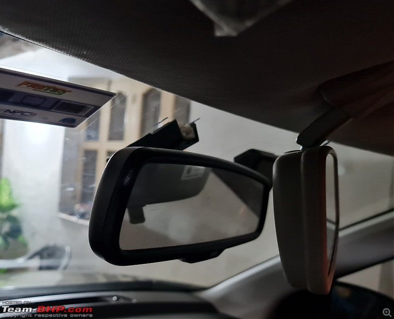

-Weird features distribution: A 12L rupees car doesn't get Auto Dimming IRVM,

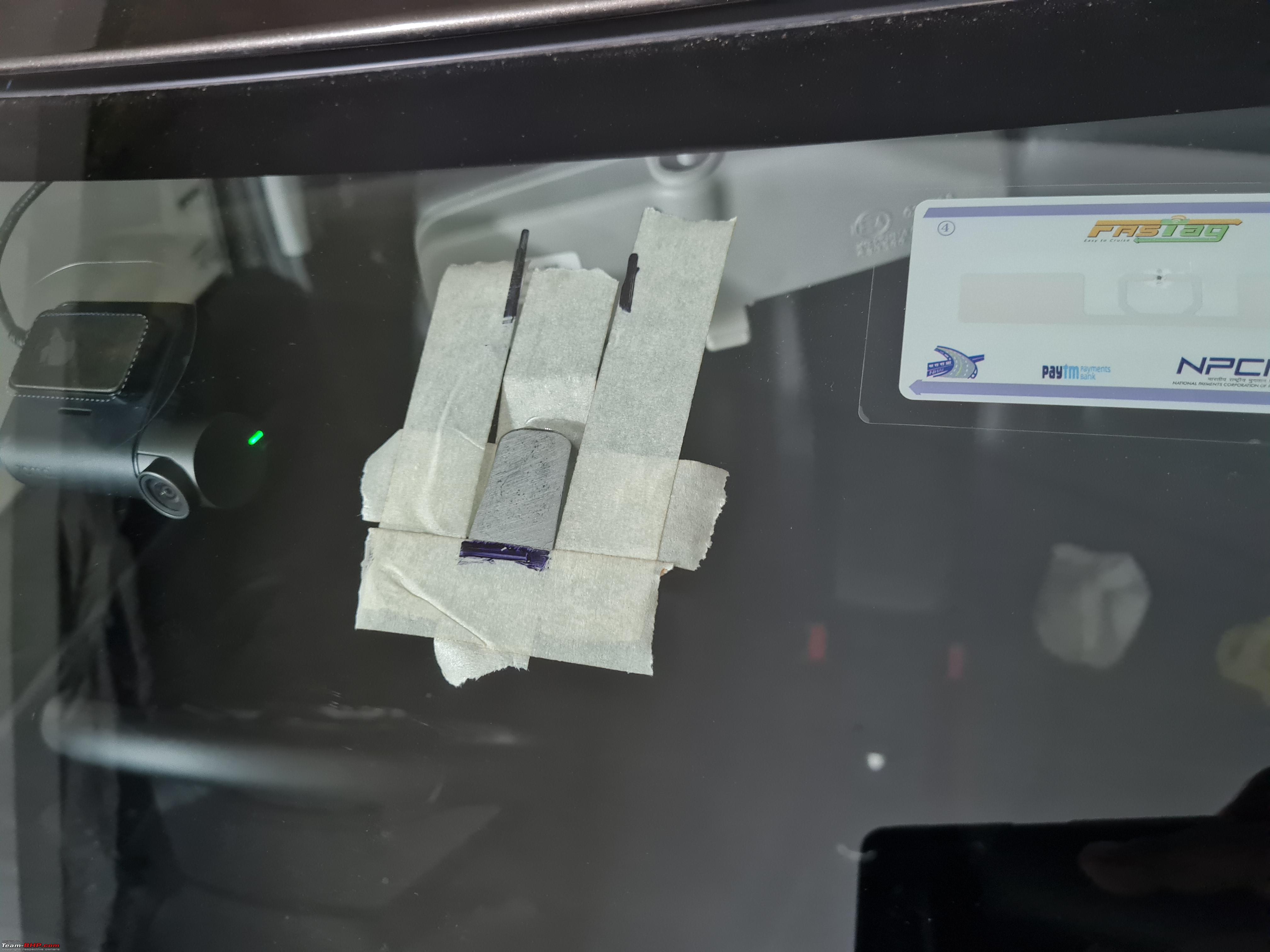

Teaser: Another big feature added! Extremely happy and proud about the same. Maruti tried to be stingy with the features, nevertheless, this is my car! #Built,notBought
Detailed post coming up soon. I have to hide the mounts with glass tape just like it is in the original fitments, route the wires, install 2nd cover. Should be done by tomorrow.
My first car: 2020 Maruti Suzuki XL6 Alpha MT Review-20210628_190634.jpg
My first car: 2020 Maruti Suzuki XL6 Alpha MT Review-20210628_192704.jpg
You just provide with the teasers. Rest the general public will understand. Right
That DIY Ceramic Coating thread is due. And make sure you upload a proper post for this update. Including a video if possible. So that the world can see what mischeif you've been upto. I know you enough to be assured, this is no less than a perfect job executed by you. Provide us with the final full update soon.
Awesome Shashi, big fan of this feature. Our Ecosport comes with this feature & I find it very useful for night driving, I also consider this as an important safety feature (for night driving).
Like all your projects, I am sure the outcome would be perfect & like a OE fitting. The auto dimming feature on our Ecosport (& most other cars I believe) gets deactivated when the reverse gear is engaged, if possible try to implement that as well.

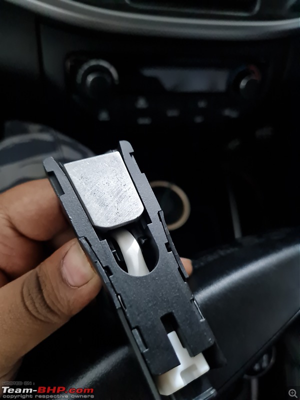

However one big drawback was that coupler location and type of Celerio mirror was way different than usual Maruti's IRVM found in Baleno Ciaz etc which have hidden wiring. In Celerio a bit of wiring will be visible, which I didn't want for the XL6.
Compare the middle point of Both IRVMs. Upper one is Baleno's OEM mirror while bottom one is that of Celerio's kit:
My first car: 2020 Maruti Suzuki XL6 Alpha MT Review-20210519_201744.jpg
We had recently procured an S Cross and I compared the mount given in S Cross to that of Celerio's Kit. It was absolutely identical!
So I had the mount and glue, now it was time to procure the Mirror, caps and harness.

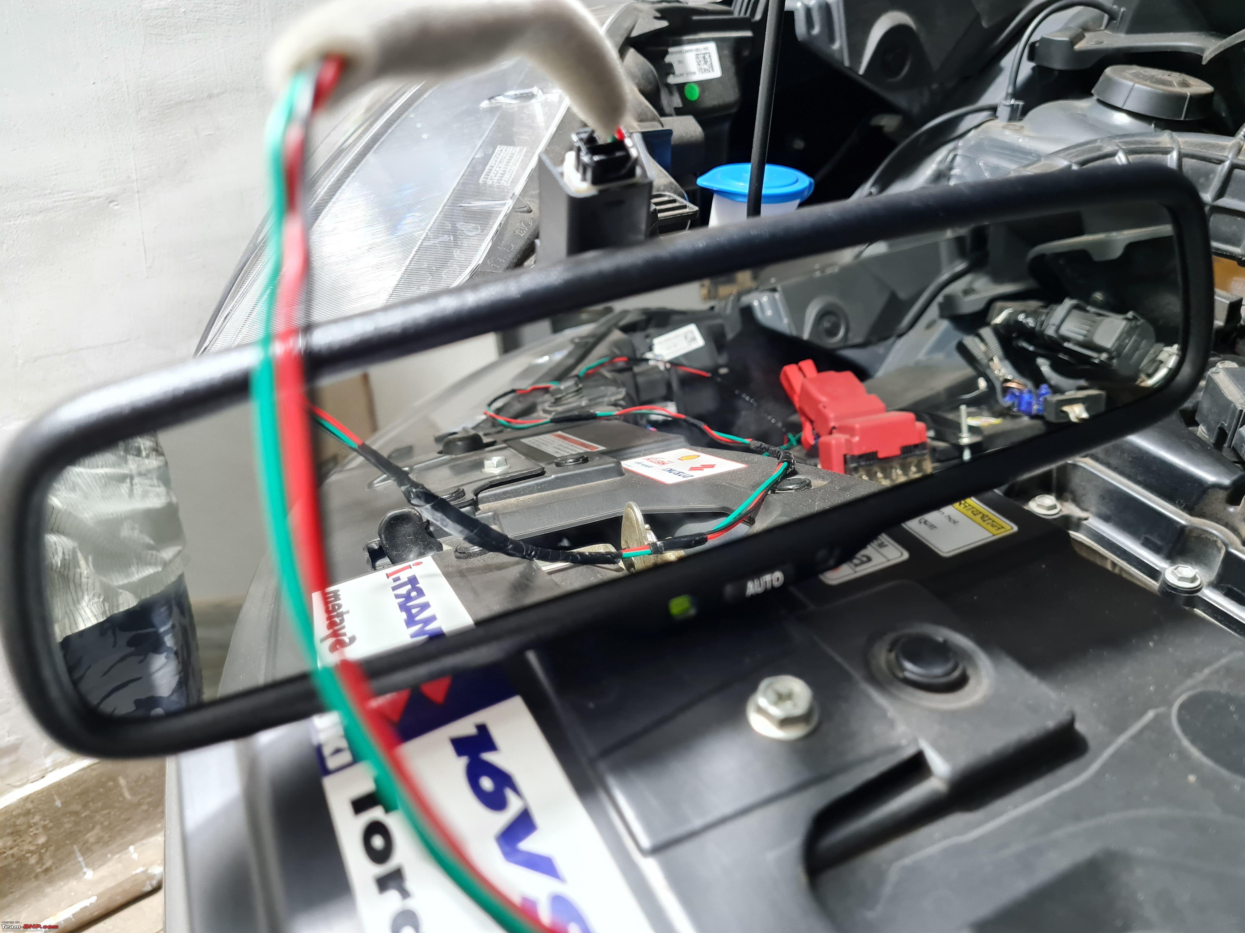

Step 2: Testing outside the car: hooked up the green and black wires to battery and tested the unit:
My first car: 2020 Maruti Suzuki XL6 Alpha MT Review-20210519_194250.jpg

Step 4: I gave the glue 2 days to settle down properly. It had become rock solid. I tried mounting the ORVM and it successfully took its weight. Drove around for a day to see if road undulations dislodge the mount. Nothing happened.
Step 5: This is the easiest step, apply the black vinyl strip on windshield(hides passing wires), connect the wire as explained earlier, put the two covers back and you are done! Also, remove the old manual IRVM. You will be left with two screw holes, put roof liner clip in them. I also relocated the dashcam a bit towards the top part of the windshield. I'll relocate the Fastag behind the IRVM and dashcam will then get properly hidden behind the IRVM on the left side.
My first car: 2020 Maruti Suzuki XL6 Alpha MT Review-20210629_173243.jpg
My first car: 2020 Maruti Suzuki XL6 Alpha MT Review-20210629_180301.jpg
The bigger Toyota feeling jealous with this latest addition
My first car: 2020 Maruti Suzuki XL6 Alpha MT Review-20210630_073459.jpg
Meanwhile Maruti's "Cost Optimization Department" after seeing this post:
My first car: 2020 Maruti Suzuki XL6 Alpha MT Review-765.jpg
Some small yet significant points:
1. S Cross, Brezza and Baleno owners of lower variants don't need to do so much circus. Just get harness of roof of Alpha variant of your model, mirror, the covers and you are done. Example: https://www.team-bhp.com/forum/diy-d...m-s-cross.html (DIY: Auto-Dimming IRVM (S-Cross))
2. Even Toyota Fortuner and Innova owners can do this in similar way, again you don't have to paste mount on windscreen, you can use existing mount and using Maruti parts, you can install this mirror. Example: https://www.team-bhp.com/forum/diy-d...ding-orvm.html (DIY: Toyota Fortuner Type 2 - Auto Dimming IRVM & Auto Folding ORVM)
3. Ertiga and XL6 owners, you don't need to follow exactly what I did. For example, easiest way is to get Celerio's kit. It will have all things you need to do this mod in most basic way, although it won't be the cleanest.
You can explore other ways of procuring mount, for example from your workshop. A lot of Baleno/S Cross etc get their windscreen changed and you can easily source the metal mount from their broken windscreen. For glue, you may use some other glue. Final aim is to ensure the mount doesn't fall, and there can be a lot of solutions like JB Weld Clear.
4. I didn't use vinyl below the mount as IRVM needs to be adjusted constantly and since the setup is heavy, I didn't want the strength of the mount to be dependent on a thin piece of vinyl. Hence skipped it.
Again, a video of the Auto dimming working :

* Regarding XL6's behavior with IOCL's XP95: One very evident difference is that I need to press the throttle lesser to maintain a specific speed, which directly translates to better mileage. Other than that there is absolutely no difference in flat-out acceleration or pick up.
