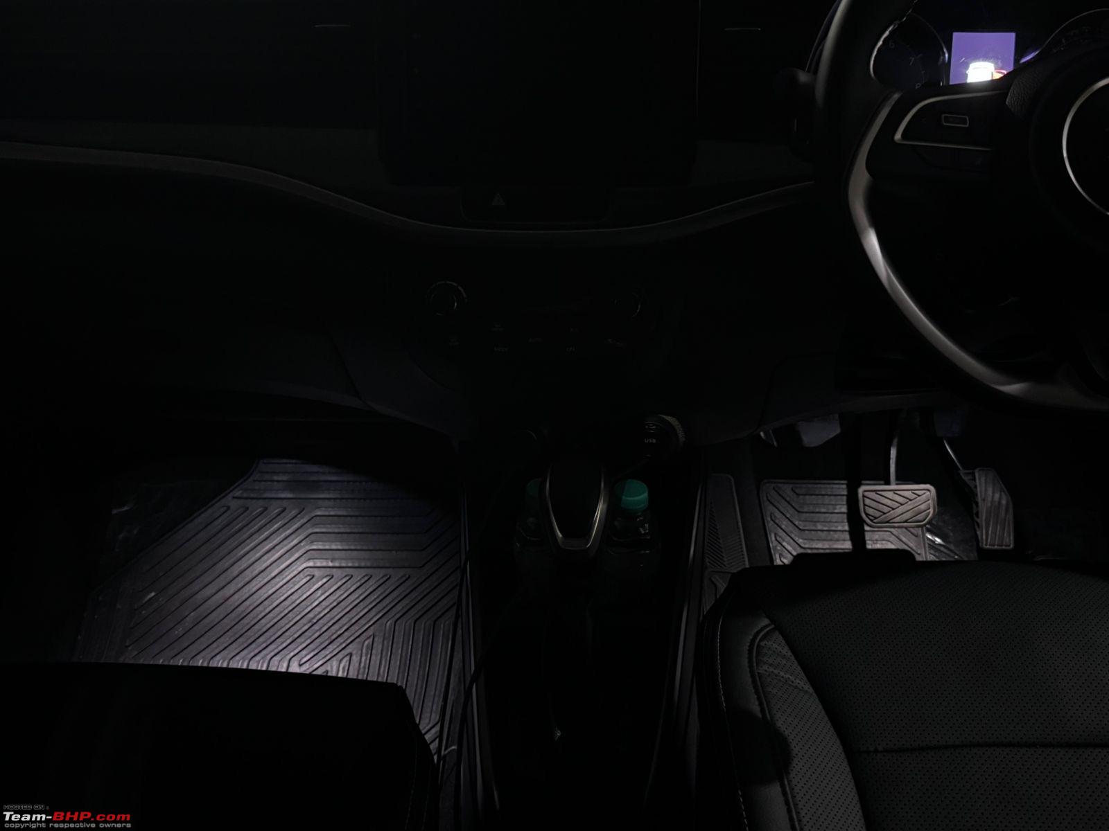

It should be possible as long as the positive and negative lines are wired correctly. Here’s a picture of how the setup looks at night time:
My first car: 2020 Maruti Suzuki XL6 Alpha MT Review-e2dbcd4039fa4599a9894a464057a384.jpeg
