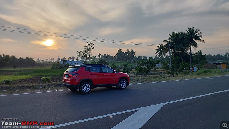

ODO crossed 1,65,000 Km just after the breakfast stop
