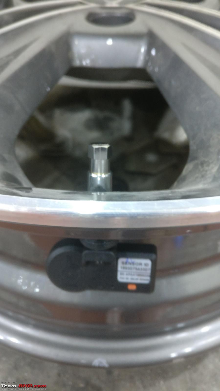

TPMS valve stem in position for fixing into it's correct position
Hyundai Creta 1.6L CRDi SX(O) - An Ownership Log - Update: 1,00,000 km up!-3.-tpms-valve-stem-position.jpg

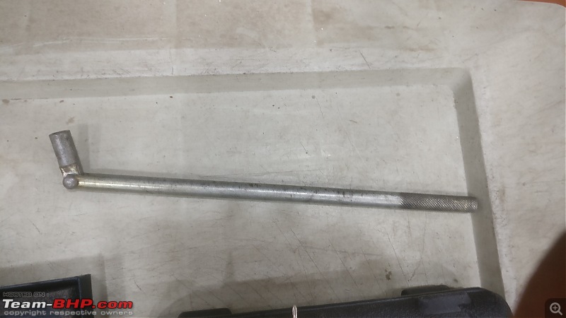

Tool required to pull the valve stem into it's correct position
Hyundai Creta 1.6L CRDi SX(O) - An Ownership Log - Update: 1,00,000 km up!-5.-tool-used-pull-fit-valve-seat-place.jpg

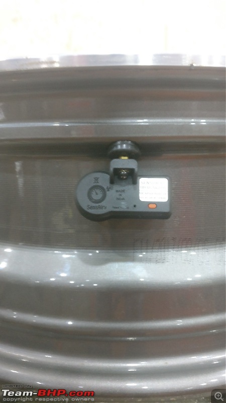

Sensor fit and tightened
Hyundai Creta 1.6L CRDi SX(O) - An Ownership Log - Update: 1,00,000 km up!-7.-sensor-fit-tightened.jpg

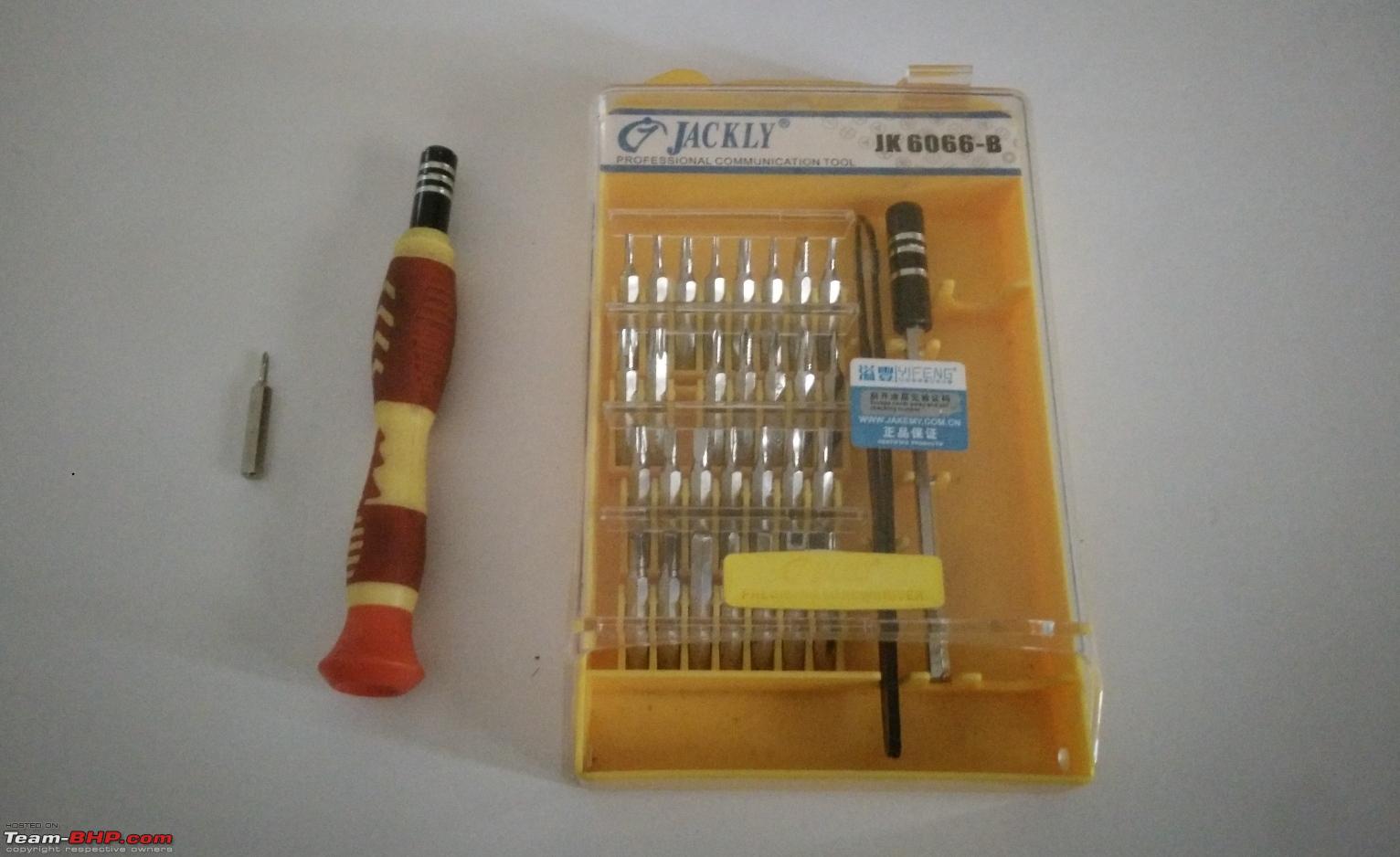

Screwdriver # +2.5 to be used to tighten the sensor to the valve stem
Hyundai Creta 1.6L CRDi SX(O) - An Ownership Log - Update: 1,00,000 km up!-12.-screwdriver-2.5-used-tighten-sensor-stem.jpg

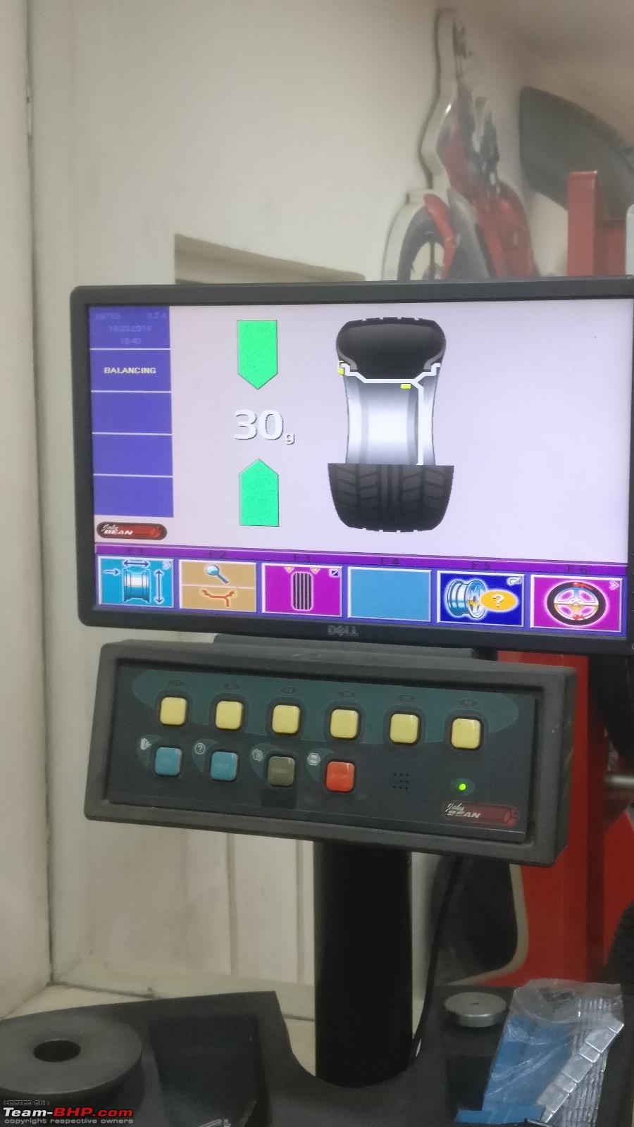

Balancing done
Hyundai Creta 1.6L CRDi SX(O) - An Ownership Log - Update: 1,00,000 km up!-13.-balalcing-done.jpg
