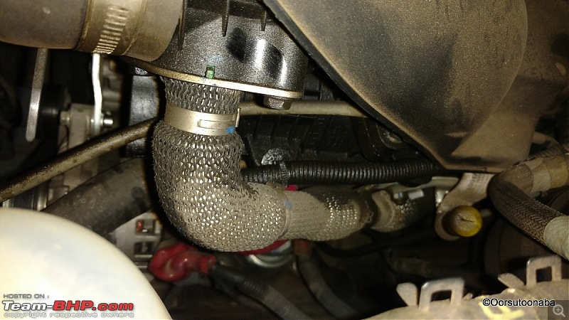

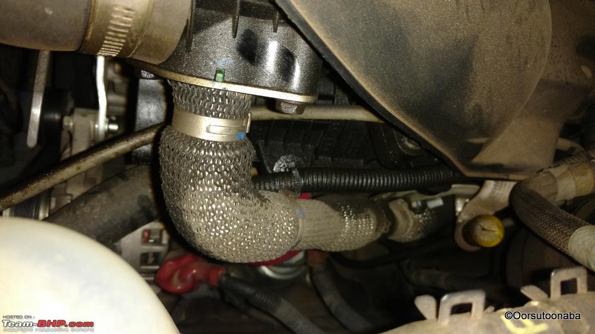

Been a hectic few weeks and I haven't been using the car much in the last month or so. Odo still stands at 27.5K kms. I had posted about the car feeling lazy on Parag's ownership thread and over the last couple of highway drives, I felt that the car was not responding to usual throttle input and I really had to feed it a lot more fuel to get moving. Even the pull from the low rev torque was not as pronounced as it used to be. FE over the last 2 tankfuls had dropped to 12 - 12.3 kmpl from 13.8 - 14.4 kmpl and its was a bit of a worry.
Earlier this week when I was climbing up an incline the car was struggling with 5 adults on board in first gear and I realized that I might have a real problem on my hands.
Opened the bonnet and I see oil leaking on the side of the engine. Didn't use the car for the last few days and today I drove to MASS to get this as well as the pick up problem fixed.
Oil leakage
Red Dwarf – My 2016 Mahindra TUV300 T8 Manual. EDIT: Now sold-4o1.jpg
Red Dwarf – My 2016 Mahindra TUV300 T8 Manual. EDIT: Now sold-5o2.jpg
IG was pretty quick today and my SA ensured that everything was done right. After removing the engine cover, the intake manifold inlet was opened and the O rings were put back in place along with some sealant. I asked for the fuel filter to be replaced as my assumptions was that this is what is causing the lethargic response to A pedal input. One look at filter and I decided that I will change the same every 20K kms as it makes no sense to wait 40K kms and drive with such a bad filter.
Fuel Filter - 27.5K Kms
Red Dwarf – My 2016 Mahindra TUV300 T8 Manual. EDIT: Now sold-1f1.jpg
Apparently my car had a retro (mahindra speak for recall) for radiator fan and hence that was also changed. Would urge other owners to also check and get the replacement even though its not a red category retro.
Take the car out for a long test drive and it still feels very sluggish. I feel no improvement in response to A pedal inputs and the pull from the low rev torque was missing. Now I was really worried. After a quick discussion with the senior service in charge, it was decided that all the vaccum hose will be changed and then we will check response.
Vaccum hose
Red Dwarf – My 2016 Mahindra TUV300 T8 Manual. EDIT: Now sold-3v1.jpg
Pull out, plug in and all vaccum hoses were replaced. A quick drive confirmed that the car was back to its usual responsive self and I quickly settled the bill for fuel filter replacement and walked out.
Planning to take the car out tomorrow and stretch its legs to see how it performs and check for oil leakage.

So what was the fuel filter cost?
Rs 520 for the filter and 165 Labor.
there could have been some useful life left in the fuel filter (although it was apparently looking dirty)
Agreed but I think 30K kms would have been pushing it.
Its strange how come these vacuum hoses get loose over time and replacing them solved the pick-up issue. What was the technical reason behind this?
Heat is the primary reason. The new hose was a lot more flexible than the ones that were replaced. My hypothesis is that because of the quality of hose used and heat that it is subjected to, especially during long distance drives, the hose will tend to expand and harden. That means the tolerance changes and hence can have an impact on performance.
There was nothing wrong with the turbo as I could hear the whistle and assuming that the fuel lines and filters are OK, this was a logical next step to check before looking at the fuel system for problems.

Drove 430 KMs today with the last 70 odd kms in Bangalore traffic. The O Ring seems to be holding up as I did not see any oil leakage at the end of the day. FE after topping up the tank was 13.5 kmpl which is much better than the 12 kmpl that it was delivering. Happy with that because most of the drive today was at 110-120 kmph and the car was just purring along. I had a big smile plastered on my face as I let the torque flow and rode the wave The small joys of driving a small diesel car!

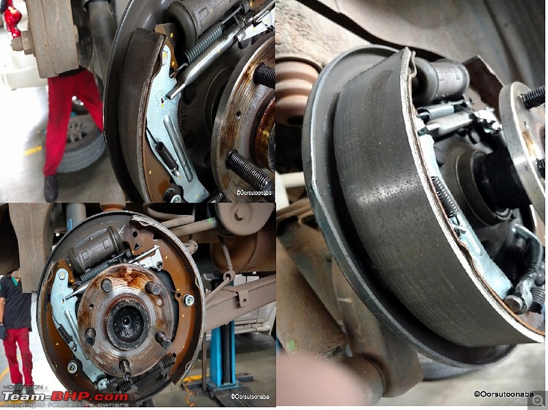

Reluctantly decided to take my car to IG for the 30K service as I did not want to impact warranty and my odo was at 31.7K kms. Was mentally prepared to spend the whole day there but surprise surprise, I was back home within 2 hours
Reached IG at 10 am and told my SA that I need to get 30K service and here is what is already done:
1. Fuel filter replacement
2. Oil + Oil filter
What I need done:
1. Air filter clean/Replace
2. Brake condition check
3. Right front fog lamp bulb to be replaced
4. All the usual torquing of nuts and general checks
What I dont need:
1. WA/WB
2. AC vent cleaning
3. Washing + Interior cleaning
As usual I expected them to take their own sweet time in assigning a service tech to work on the car but to my surprise, someone was assigned immediately and started work as soon as the car was in the Bay. I was pleasantly surprise and watched on as the tech did his job & I must say he did a pretty good job of checking things and ensuring everything was OK. Then one more tech joined him and they were motoring along and wrapping things up quickly.
The Sr. Service manager (SSM) walked by and I was asking him about MLD and was generally taking to him, when I asked if they can do something about the seat-belt. Mine was replaced sometime ago but even the new one was as bad as the old one and just did not retract. The SSM mentioned that the issue was with a 42T spring in the seat belt mechanism which was failing to compress and pull back the seat belt. He also mentioned that new spares with modified spring should be arriving soon and then I can ask for a replacement.
Within the hour, all work was done and I was grinning ear to ear.
  • Checking & cleaning of break pads.Both front and rear brakes look good and hence not changed.
  • According to the SA, AC cabin filter had to be changed but my filter was in pretty good shape and hence decided to hold off. Was pressure washed and put back.
  • Changed the Air filter as it had run 12K kms and was a little grimy.
  • All fluid levels checked - nothing needed to be topped up
  • All nuts/bolts torqued
  • Visual inspection of suspension and bushes
  • Visual check of belts and alternator
