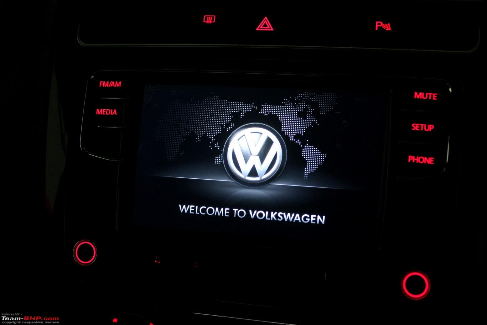

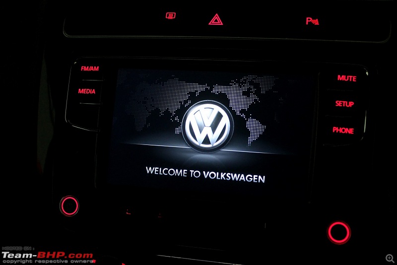

The splash screen which I rarely get to see since the unit boots almost instantly:
VW Polo GT TDI ownership log EDIT: 9 years and 178,000 km later...-img_4331.jpg

Also got my HU changed to the RCD 330G + MIB 2 unit.
For 105 USD inclusive of Aramex shipping to Chennai with zero duties, I have zero complaints!
As always, massive thanks to the Russian folks!
Bro. Would it be possible to share the part number or the link / contact from the place you sourced the HU?
As posted in the Rapid thread, I'm looking to upgrade to a headunit with Navigation support and this with Mirrorlink will help in a way, especially being an inexpensive unit.
I wonder if Skoda will be interested to sell one through its Accessories department for my Fabia.
