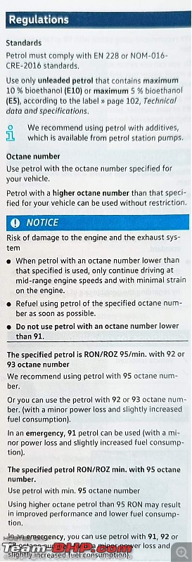

So, how do I know which gas to get for my car?
To know which gas your engine is designed for you should read your owner’s manual. Also, if your engine is a high-performance engine it most likely will have the higher-octane rating posted on the gas filler door as a reminder.
So I have a fairly simple question. The manual of my car (1.0 TSI) says use 95 octane and in emergency it is okay to use 91 (slight power loss and lower fuel efficiency) Attached is the part of the manual that describes this. Can you please break it down for us whether its okay to use 91 regularly in normal city and occasion highway driving conditions?
Is the only difference power and mileage or can it cause more engine wear and tear/damage?
Thanks!
Explained : Octane Number, Cetane Number, Fuel Myths & Mixing Different Fuels-fb_img_1693066469293.jpg
