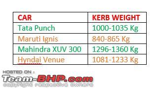

From what I understand based on the numerous discussions we had here in the forum, there are two ways of improving structural safety -
  1. Using thicker steel members
  2. Using higher grade steel with minimal weight gain
Obviously, the first route is the lower cost option among the two. Tata and Mahindra had generally taken the first route as is evident from the weight of their cars in comparison to the lower safety competition.
I am quite aware that you can have higher safety with lower weight, but generally in segments less than 20 Lakhs, that is not what Tata and Mahindra have done.
Then how do they maintain fuel efficiency with the higher weight? Especially in the case of Tata in lower segment cars, it is managed with lower power engines compared to the competion. That in part, explains the lower power engines in Tata Punch, Altroz and Tiago.
Now analysing the options for Hyundai, Kia and Maruti (models other than Brezza and S Cross). They cannot go for heavier cars and suffer lower fuel economy. That will kill their markets. Also, they do not wish to go for significantly lower powered engines, as the peppy engines they give are loved by their customers.
So when designing cars for India, their thinking is always "what to give for a given price - higher structural safety with higher grade steel or better features?" The answer is always the bling features. This has been highly successful so far, as is evident from the sales figures. Times may be changing - but we are not there yet.
So it is not just a matter of amount being spent for safety. It is the amount to be spent for safety without compromising fuel economy. If much higher grade steel is used for the structure, the cost difference on on-road price could be as much as 1-1.5 Lakhs. This could make or break a model, especially in the sub 20 Lakh segments.
Once customers are asking for safety ratings, all this will change and safer cars will be introduced. The move towards strong hybrids and EVs could be very important in this aspect. Then you can have higher kerb weights and powerful engines without compromising much on the running costs.
