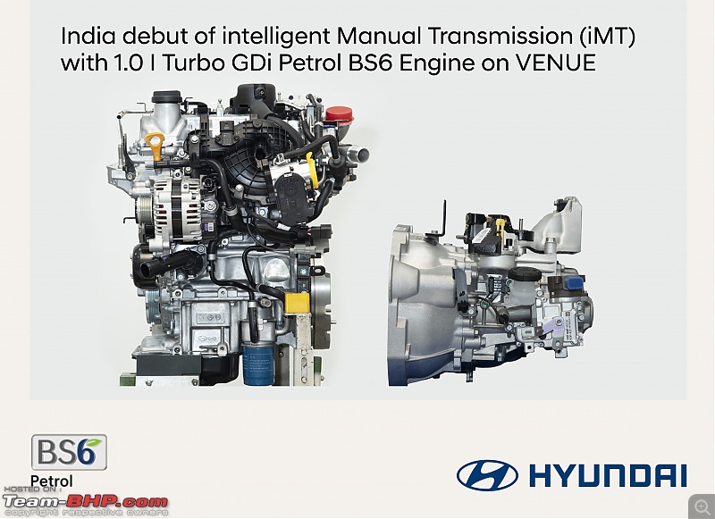

Sharing full press release here. Quite a unique offering, I must say. Will call for it to review. If someone wanted to save money, I'm wondering how this is better than an AMT?
Hyundai Venue 1.0L turbo-petrol to get clutchless 6-speed iMT. EDIT: Launched at Rs. 10 Lakhs-hyundai-imt-1.0-l-tgdi-engine.jpg
Hyundai Announces India Debut of intelligent Manual Transmission (iMT) Technology on VENUE – India’s First Connected SUV
First-in-Industry 2-Pedal intelligent Manual Transmission (iMT) Technology
- Hyundai VENUE First Brand to bring iMT to Indian Customers offering a Clutch-less Drive Experience
- iMT to be introduced in July 2020 on Kappa 1.0 l T-GDi Petrol (BS6) engine with 6-Speed Manual Transmission
- Enhanced control through manual gear shifting without need to operate clutch for a comfortable and superior drive experience
Mumbai, July 03, 2020: Hyundai Motor India Ltd. (HMIL), country’s First Smart Mobility Solutions provider and the largest exporter since inception, today announced India debut of intelligent Manual Transmission (iMT) on Hyundai VENUE – India’s First Connected SUV. Continuing its technology leadership, Hyundai has announced the introduction of yet another Industry First Innovation that offers customers the convenience of 2-pedal clutch-less technology combined with Fun-to-Drive elements of a Manual Transmission.
Hyundai’s iMT technology is essentially a revolutionary 2-pedal system that eliminates the need for drivers to constantly use the clutch pedal as in a conventional manual transmission. However, with this technology the driver retains the ability to slot gears manually, thereby delivering enhanced control and retaining the joy of driving.
Commenting on the announcement, Mr. SS Kim, MD & CEO, Hyundai Motor India Ltd., said, “Hyundai has been driving the adoption of new and innovative technologies at scale. With our ‘Future Ready’ business strategy, we have been continuously striving for customer delight with Human centric technologies that present our innate understanding of what our customers’ desire. iMT is one such technology that accounts for pleasure of driving and also the convenience needed to ease the hectic burden of daily commutes. This unparalleled drive experience on Hyundai VENUE – India’s First Connected SUV has been curated through a constant pursuit of innovation for Customer Delight.”
Hyundai’s iMT technology features a Transmission Gear Shift (TGS) Lever with Intention Sensor, Hydraulic Actuator and Transmission Control Unit (TCU). The system has been designed to offer a seamless drive experience by incorporating a cohesive logic between the various components on manual transmissions:
- Transmission Control Unit receives signal from TGS Lever Intention Sensor, indicating drivers desire to change gears.
- TCU sends signal to engage Hydraulic Actuator forming Hydraulic Pressure.
- Hydraulic Pressure is then sent to Concentric Slave Cylinder (CSC) through Clutch Tube.
- Concentric Slave Cylinder uses this pressure to control the clutch and pressure plate, thereby engaging and disengaging the clutch.
- Driver is able to seamlessly shift gears without the need to mechanically operate clutch pedal.
Through this electromechanical operation of the clutch, iMT will offer drivers all the pleasures of driving a manual transmission. Further, the technology will empower customers with a more engaged drive experience by offering enhanced control over desired torque on wheels without compromising on fuel efficiency and performance.
