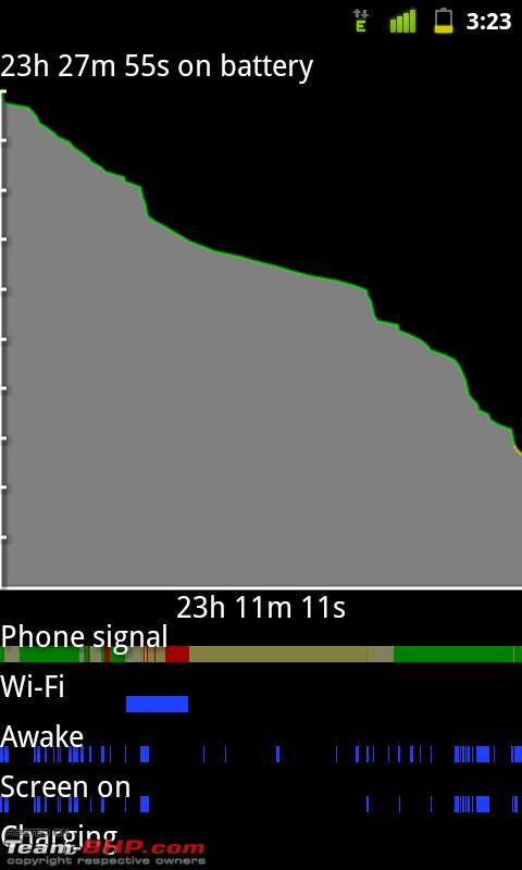

24 hours with a single charge and still 25% remaining in a power hungry HTC Desire.
Highlights
- Mobile data or Wifi all the time ON
- GPS Occasionally
- NO Juice defender to cut down on mobile data
- NO Auto task killers
- Online in Gtalk all the time
- No 'flight mode' usage during this time
- E-mail sync ON, every 30 minutes, 2 accounts.
- Many voice calls, some amount of browsing and chatting, few SMS.
Here's the combo I used to achieve this.
ROM - CM 7.1.0 RC1
Radio - 5.17.05.23 (Latest for Desire)
SetCPU installed to crank down CPU speeds while display is off. (700 Mhz max while display off)
Auto brightness set
Latitude turned off in Google Maps. (Partial wake usage reduced significantly)
Set to use only 2G networks
I am not sure whether it is CM7.1 or SetCPU which contributed much to save battery but anyway this set up is really nice. I could never achieve this much battery life without turning off the data before.
