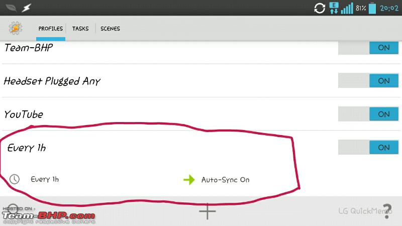

To all tasker gurus.
I started using tasker today. Pls guide me if i have done the below correctly.
I want my gmail and other email accounts to sync every hr rather than sync always ON.
This I think will not increase your battery life. Because you are only toggling sync. Your data is always ON. In my opinion, you should toggle data every one hour to get the best battery life.
Let the sync be ON all the time.
