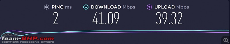

On the other hand, I just did a speedtest and surprisingly I got 40 Mbit sustained Download speed.
Attaching results snap.

The correct test is to do it via ethernet cable or if your router has a built in speed test. If you use 2.4Ghz band usually you will see the speed in the range of 40-60Mbps.
I am 6 feet from my gaming router and have a 200Mbps connection and this is the result around 80Mbps. https://www.speedtest.net/my-result/a/6529533020
