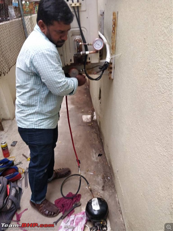

I went through this same nightmare due to shoddy work by the ac technician recently. Cooling was very poor and my regular guy was busy so called on another chap. He came in removed the IDU, pressure washed it, refilled gas which was probably not needed then and fitted it back. In the process he broke the plastic latch of the rotating drum on one side. It worked for a few days and lost cooling. He came in refilled gas and went. Lasted a few days and again leaked. Finally got hold of my regular guy. He came in and found that the previous guy had not joined the IDU to the copper pipe going to the ODU well and there was a leak at that place. So he suggested a gas leak test for 24-48 hrs and refill of gas post that. He rigged up as per the attached pic. Since then my Daikin which is about 12-13 years old has been running well.
I suspect the previous guy has done some damage to the joints and that is the reason for you losing gas. You can insist he only checks the joints and the gas pressure and refill and go but for peace of mind you can do this. I think I paid around the same price.
You can attempt with another ac technician who has good references. No need to go with company guys for this. It is outsourced anyway and not that they are giving you any warranty.
The home / office air-conditioner thread-1587794122182.jpg
