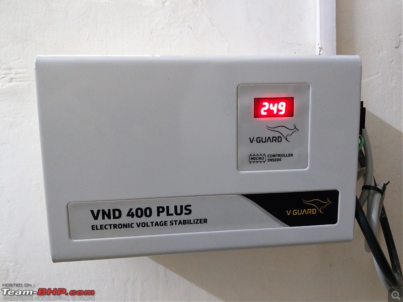

The technician came last evening. He switched on the power. The AC was working normally. He checked the ODU as well and found nothing wrong.
We connected the AC to the power directly and it was working normally. So we decided to replace the stabilizer. It was 12 years old and guess it has become cranky. It was replaced this morning.
Fitted a new stabilizer (V-Guard VND400 plus) with voltage info displayed in the front. It shows 240-250 some times. The tech guy says it's fine though. Interestingly there's no bypass switch in this device. It seems to have been built in, to have a delay in case of quick power restoration.
Hoping all will be fine now. Chennai is unlivable even now with its warm climate at night. When will winter come?
Thanks to Thad sir, Aroy sir and Prowler for your inputs. I was calm about the issue only after reading your posts.

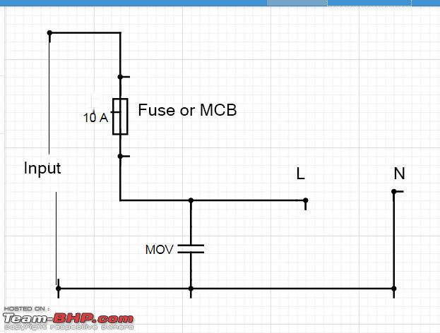

I have attached a typical 3 phase SPD which can be fitted in your mains after the utility meter and fuse carriers.
As you can see it is for a 3 phase supply and it is a heavy duty unit. There are many manufacturers as I mentioned earlier.
I also have a circuit diagram of how a Metal Oxide Varistor (MOV) has to be connected. Please note that the circuit diagram tool I used didn't have the proper symbol for a MOV and hence I used a capacitor symbol here.
