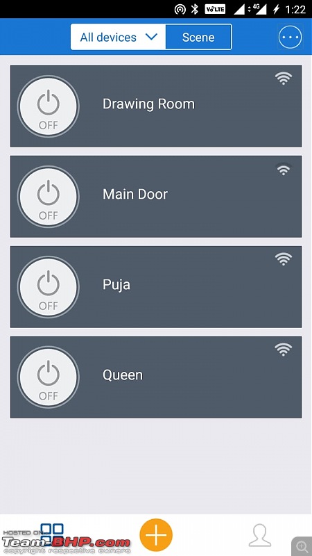

I totally agree. But where have you sourced your collection from and at what rates? AliExpress is cheapest but the delivery timelines are terrible. Amazon is great but pricey.
Everything from AliExpress. My recent order of 5 basic devices reached me in 11 days.
Amazing! Using paid shipping or free? Please list out your switches / plugs / devices for our benefit.
Will request mods to move these posts to a new thread shortly. Here is my motley collection:
The home / office air-conditioner thread-whatsapp-image-20180519-1.22.35-am.jpeg
