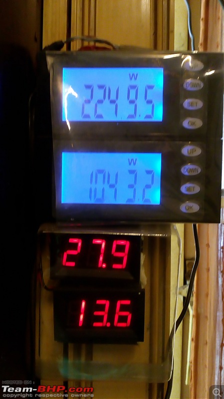

Originally Posted by SanjayDalal View Post
The logic being , technology will have progressed in these past 18 years and hopefully there will be some saving in the electric bill
Not quite. I am posting this photo of my 13 years old LG 2 ton split versus a 2 years old LG 1 ton split. The top two meters (blue) show the wattage that each is pulling. The difference per ton is barely 80 watts, and that too because the 2 ton unit had been on for only an hour and the living room had not yet reached optimal temperature, whereas the 1 ton unit had been on for 6 hours in my tiny study which was at steady-state temperature.
The home / office air-conditioner thread-img_20170613_131725.jpg
