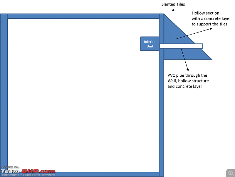

... The wall on which the AC is an internal wall. So, they have provided a 3" concealed PVC pipe on the wall which is brought out on the external wall. Due to some obstacles, this PVC pipe has one elbow joint on each end. .....
Is it only one elbow at each end or is it two at each end?
Is the PVC pipe run horizontal or vertical?
It is one elbow at each end. The PVC pipe is running horizontal.

1. Is there any other flexible copper pipe that can be routed through a bent PVC pipe?
2. Does any other member here have an AC mounted on an inner wall and had to route the copper pipe to an external wall? How did you manage this?
3. What is the nominal price of copper pipe? As this is my first AC I am not sure if Rs.350/ft is the right price. The quality of the pipe looks very good though.
Thank you in advance for all the guidance.
1. Not possible. The pressure rating is too high and the soft copper tube may burst
2. Use openable electrical conduit - Legrand has a square conduit (expensive - Rs. 700 for 3 meter!)
3. The copper wont cost that much - but it includes their work, brazing and all other stuff. With other stuff also included, looks ok.
Thank you very much for the information. I have decided to punch a hole through the external wall and fix the AC. Will update once the installation is complete.
I can't quite understand the geometry, but a solution that would work is to use flexible high pressure hoses (as used in cars).

Originally Posted by vnabhi View Post
I wonder which member would buy a split AC and install both the external unit and indoor unit on the inner wall.
To answer your question, everyone instals the AC unit on the inner wall and the external unit either on the external part of the same wall or a little away, to avoid noise from the external unit.
My apologies that I was not very clear in my wording which led to the confusion. I am completely aware that a split AC has the interior unit inside the room and the external unit outside
Here is a picture to explain my problem. I have marked what I meant by the interior wall and exterior wall in the diagram.
The home / office air-conditioner thread-ac-position.png
As you can see, there is a PVC pipe through the interior wall that is brought out to the exterior wall. This has an elbow joint on both the ends and my problem is that the copper tube connecting the internal and external AC units cannot be routed through this pipe.
In your case, it appears to be unique as you say there are slanted tiles on the wall. I am not able to visualize what you're saying, but making a hole is unavoidable.
As regards cost, I think you got a deal. I paid Rs 1400 for 2 meters of copper wire when I bought my OGeneral 2 T AC last month.
Below is another diagram that shows the tiles arrangement.
The home / office air-conditioner thread-room-side-view.png
This is the side elevation view. Exactly on the other side of the AC unit, outside the wall, I have the slanted tiles which have a hollow part and then a layer of concrete built on a net to support the tiles. To bring out the copper pipes, a hole has to be drilled through the wall, the concrete layer and the tiles. This is again a challenging job and involves lot of masonry.
Hope my problem is clear now!
