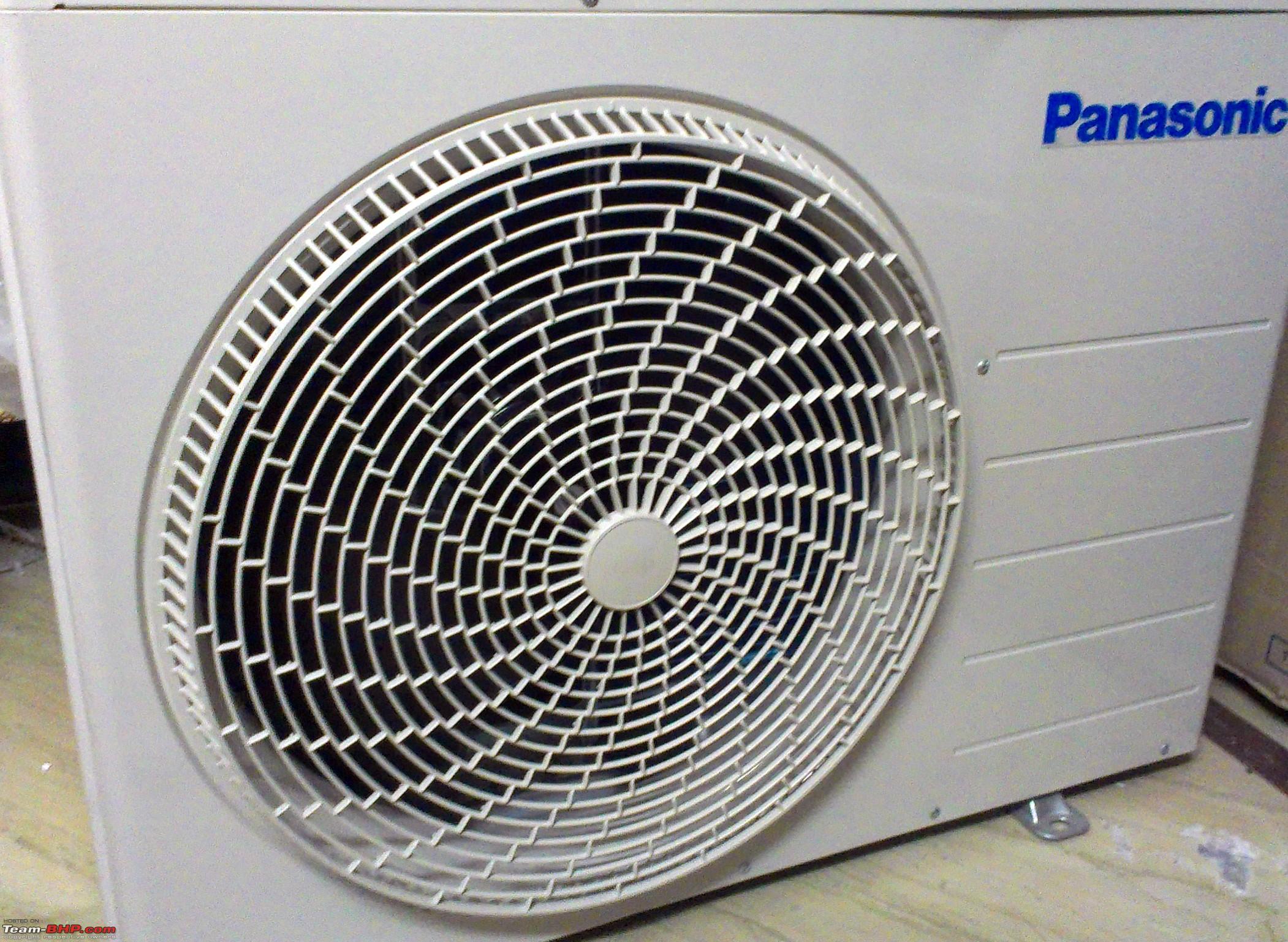

Finally bought Panasonic 1.2 Ton Split A/C for Rs. 18000. After considering various options I finalized for this A/C considering its price and size.
Installation will be done tomorrow, will post detailed review and pictures upon installation.

Originally Posted by bluevolt View Post
Finally bought Panasonic 1.2 Ton Split A/C for Rs. 18000. ...
Is this the Cube?
I don't think the other split ACs are available at this price point.
anupmathur is offline
Old 12th April 2013, 21:09   #2935
bluevolt's Avatar
Join Date: Jan 2011
Posts: 3,274
Thanked: 3,477 Times
re: The home / office air-conditioner thread
Originally Posted by anupmathur View Post
Is this the Cube?
Yes this is cube....just got the delivery. Is there any specific reasons why cube models are quite cheaper than routine split ACs?
