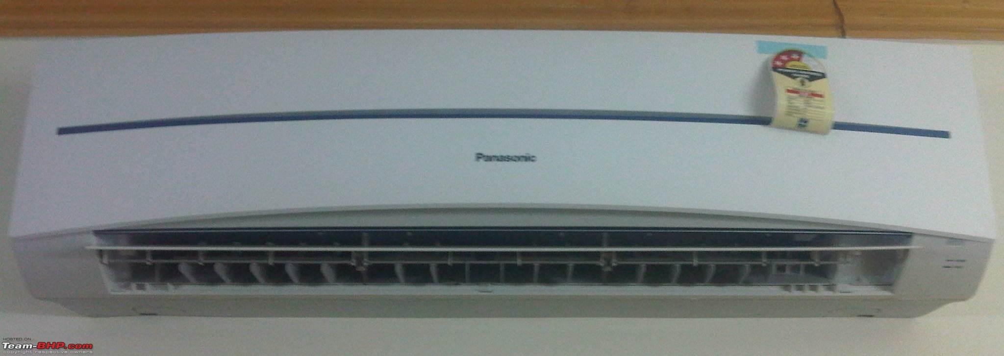

Originally Posted by sanjayk View Post
Installation of the split AC was done on Thursday(24/03). I found the outdoor unit to be bulky. I was asked to shell out extra bucks for wiring from the indoor to outdoor unit. Got to know that all the imported ones have their power drawn from the outdoor unit. I leave it to the experts to clarify.
@Tush, Best part of this is the silence. I can only imagine how silent the inverter models would be. As of now i am happy that i got the best for 27,900. I will advise folks from Hyderabad, on the lookout for an AC to consider Daikin. Bajaj Electronics was the one to offer this at such a low price, but the latest i heard is that most of the dealers are offering at the same price.
Thats really nice. Do put up some images of the install.
The home / office air-conditioner thread-dscf0794.jpg
The home / office air-conditioner thread-dscf0795.jpg
Was the installation done by the dealer or by Daikin ? The reason I asked you is based on the following -
Not by Daikin, but trained technicians of the dealer. By dealer, i am not referring to the outlet from where i had purchased.
installation is done by Daikin techs, they apply some quote to the piping and then take a snap of the installation and send it to Daikin and are at rest only once they get a confirmation from Daikin that all looks good.
Hard to believe any manufacturer takes such care. Did not happen in my case though. We are not talking about luxury goods here.
