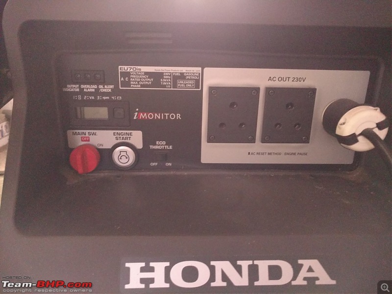

How do you maintain this Thad ? Like, do you follow any monthly or bimonthly drill to keep the gen running ? I was told by the generator sales team that generators should not be wet stored and have to be used to their full capacity biweekly.
We were told we should run it once a week. Just like my car may, occasionally, not run for a week or two, I don't think it is a big deal. When I do run it, I run it for 30-60 minutes and give it some load like an AC. It's important not to just start and stop it: just like a car, that would lead to a flat battery. Manual starting is provided, just in case, but I haven't actually tried it and I don't have strong arms!
Otherwise, service annually --- just like a car.
Here are the generator controls. The red thing is the ignition switch, the push button starts the machine.

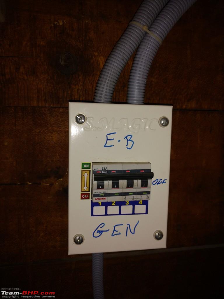

I did not know it was this easy. What is this switch called ? Is it like the phase change turn switch ?
Here is the changeover switch. This really needs to be set up by a proffessional to ensure that the generator power is absolutely isolated from the EB mains. First, for the safety of the EB guys, we should not be feeding power into their lines when their power is down, second because the generator power is shared across the three phases.
The only thing is that everything is potentially powered. The responsibility to not overload the generator is ours alone. So we have to be a little bit technical. But most people can grasp it in practice, and hey, I don't understand it in much depth!
If we are doing flood work, then I switch off breakers to other pumps, and, of course, I don't run any AC. Even the 2hp pump does not max out the generator, but the starting surge is considerable., and, in a storm it is going on and off regularly as its pit fills.
