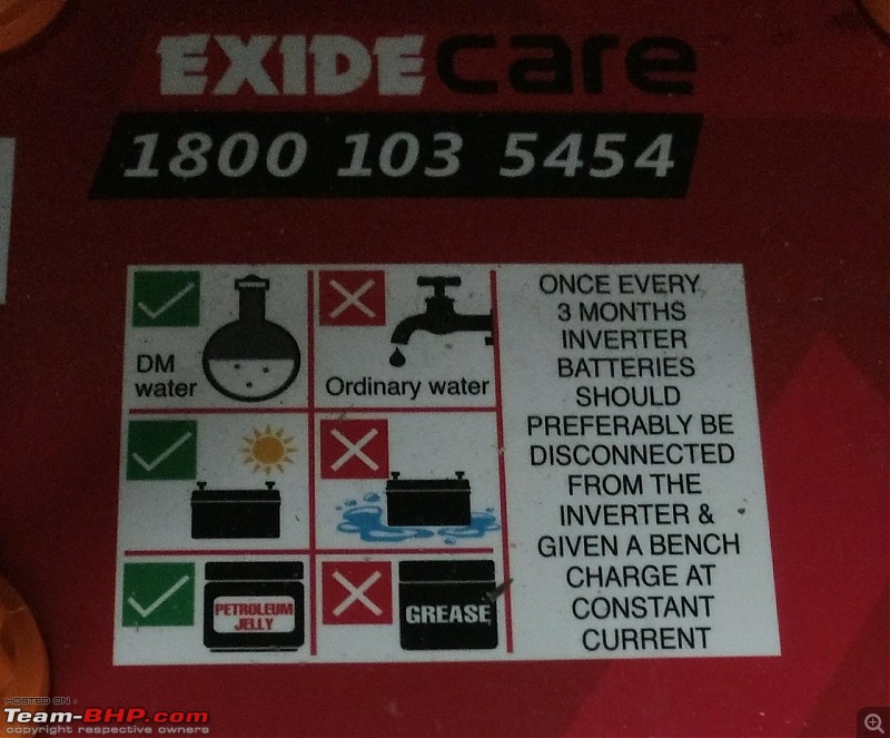

On top of this running an inverter doesn't come for free. It pulls quite a bit of AC power (guesstimate is about 1-1.25A when bulk charging and float charging probably consumes approx 0.1A/24W, 24x7 till the next blackout.
This is true and it compounds as the battery gets older. My monthly electricity bill was growing over the past months and found that the inverter was drawing constant current trying to keep the battery at float charge. The battery was 7 year old Exide and it was having trouble crossing 13V. Replaced it yesterday with Exide Instabrite 135AH.
Found this note on the new battery. What could be the reason for recommendation?
Probably refers to an equalisation charge although this is normally recommended every 6-12 months at a constant voltage (not amps) of approx. 15.8 VDC.
This higher voltage helps the battery break and dissolve sulphate crystals off the plates, and the gas mixes the electrolyte (sulphuric acid and water) which gets stratified over time in large stationary batteries. This step is also called reconditioning programs in some 'smart' microprocessor controlled battery chargers.
