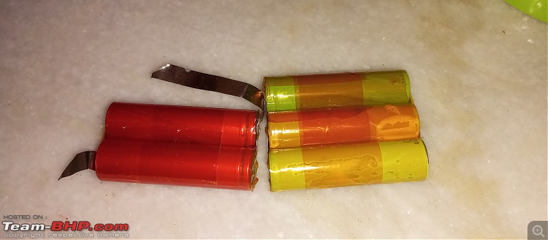

Next, the cells were wrapped with Kapton tape for insulation since there was not going to be any space left for the 18650 cell spacers. The cells were aligned properly for spot welding the nickel strips onto them. The image below shows the spot welding in progress.
DIY : Consumer-grade USB power bank-img_20240413_084520.jpg
