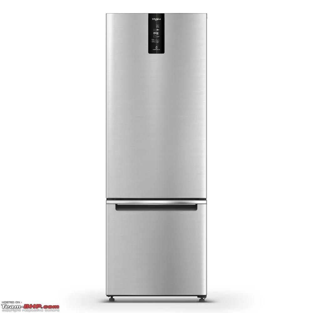

WB3560EUXX-whirlpool
The Home Appliance thread-wb3560euxxwhirlpoolstainlesssteelbottommountfridgefreezerfront_1800x1800.jpeg

I know you previously pointed out the bottom mounted fridge freezers have smaller freezer capacity but immediately looking at the screenshot it looks like your model is an 80:20 split. Googling the specs seems to confirm this with 70 L freezer capacity out of a total 313 L.
I believe 60:40 splits tend to be most common in the West, what with the reliance on freezer foods but I've rarely seen any 80:20 units. A 70:30 split seems to be a happy medium.
