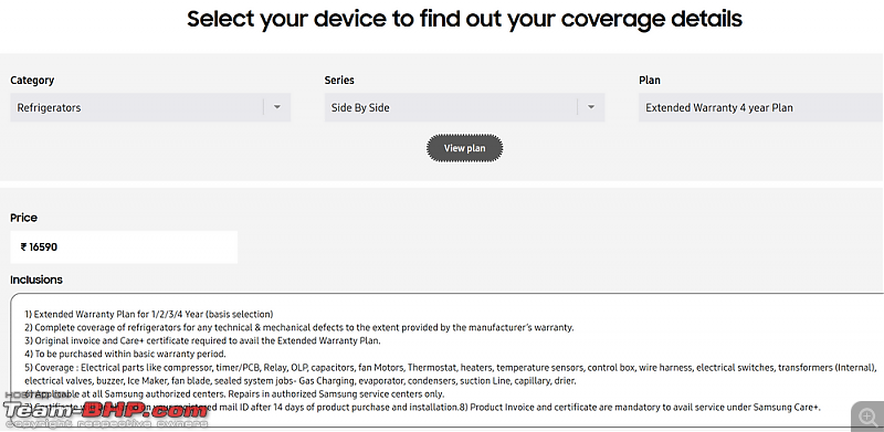

Thank you guys. Installation person called and offered Samsung care (extended warranty) at 40% discount. Is it worth it? There are 1/2/3/4 year options. Compressor already has 20 years warranty.
https://www.samsung.com/in/offer/ce-care-packs/
Attachment 2626252
Refrigerators last a long time, my samsung inverter fridge is 9 years old and running fine. It's a waste to get extended warranty on a fridge.
